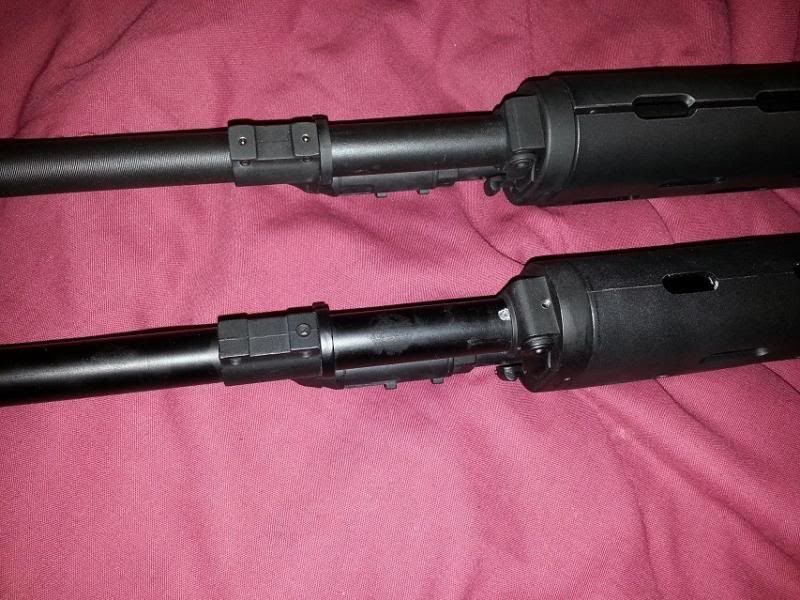

At the gas tube.
On the king arms there is 2 little hex screws holding in the assembly and only the clip to hold the hand guard.
on the A&K you have 1 larger hex screw on both the assembly and clip for the hand guard. Also note both screws are sucken slightly into the outter barrel as well for a better fit. (ignore the chipped paint that was my doing in error)
