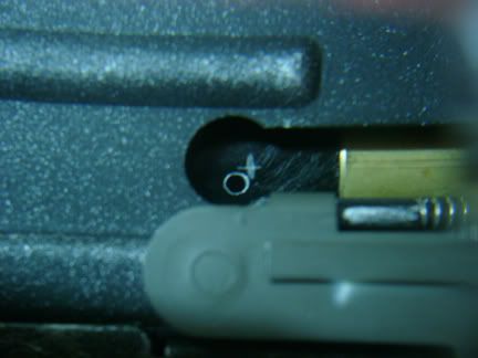

first of all, R85 is a for u to love or hate..i have one n a few mod to mk it reliable. its an aeg for experience airsofter n not for newbie. u need more discipline. btw if u wan to do DMR, u need a good hi torque motor, but once u replace the motor, the decompress button dat located in the mag well is useless.u can push it but it wont mk ur ur spring decompress. it because the strong magnet inside hitorque motor. n NEVER use lipo!!..TOO FAST CYCLE on a long piston aeg cause ur piston strip faster.
in dis case u have to drill the upper part of the gb. it for indicating whether the spring is decompress or compress position(pic). u will see the piston body tru the hole if it compress. in the pic the piston is already decompress. take a few full auto shot to mk it decompress
for parts, its a hybrid kind of gearbox n the internal, its a PSG-1, SR-25 sector gear, M14 spur gear n normal bevel gear. piston use the 18 teeth just like PSG-1 or SR25 but it use a custom made for L85 for tappet plate. i recommend u buy one pcs for spare. but d cylinder head i stil not recognize wat version use it
