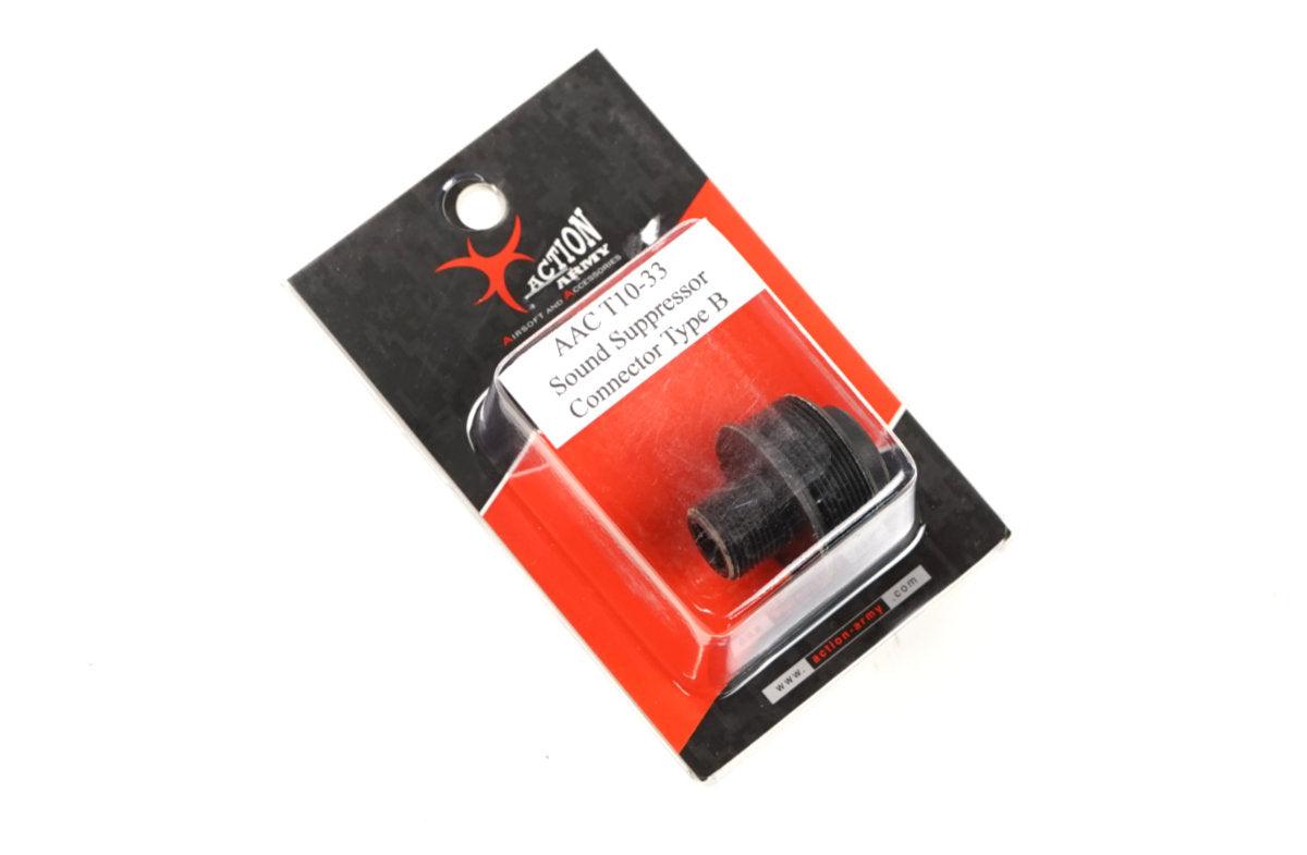

edit: also im not sure the thread adapter Silicone linked to is correct either, I took off the orange tip and the diameter on the inside of the barrel looks a bit smaller than the adapter in the link (even though it says T11) it almost looks the g-spec size on mine unless another part of the barrel threads off as well.
That's interesting.
Do you mean like a 16mm female thread like the JG or TM muzzle, or when you unscrew the end plug the actual barrel is smaller than 27mm?
There are three VSR-10 silencer adapters Action Army sells, one for the Pro Sniper, one for the G-spec/L96, and one for their barrels/guns.
I believe so. Heres a shot of the end of my barrel. There is a part break you can see but it didnt budge after taking off the orange tip and i didnt want to damage it trying to remove it.
18317
Yeah, that's the standard G-spec/17X1 CW threading.
Under that should be the 27X1 CW that all AA stuff and the TM and JG G-spec rifles feature.
Other G-spec style barrels like Novritsch, Maple Leaf, Bulltrigg, and so on may or may not be that, but I'd wager no.
