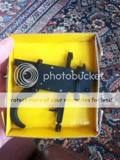

So, on with pics.
Shmancy packaging. I like.

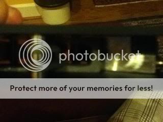

If you notice on the spring guide stopper, there is actually a little flathead screw on the bottom of the spring guide stopper with a hole going through the screw. It's not some useless screw. I've actually been waiting for a manufacture to do something like this.
The L96's stock has a slot that the spring guide stopper goes through (right in front of the trigger guard). While the gun is fully assembled, the flathead screw on the bottom of the spring guide stopper can be accessed through this slot and can also be unscrewed, thus exposing the hole going through the screw, as I mentioned before. You can stick an allen wrench in this hole, pull down, and release the spring guide stopper, thus releasing the cylinder. This is useful for if you want to change springs without completely disassembling the gun.

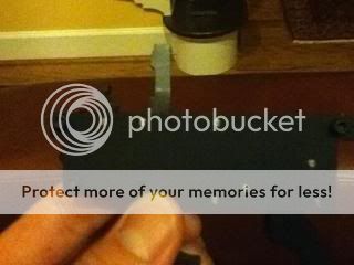

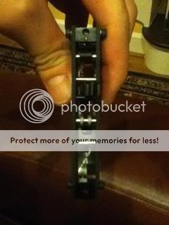

Trigger fits perfectly on the receiver. Looks just like the Laylax Zero-Trigger. Even the insides look like the Laylax trigger. It has the bearing system identical to the Laylax, and unfortunately, doesn't have a safety, just like the Laylax.

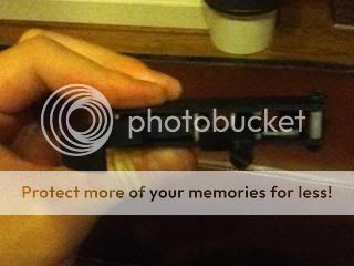

Here's the bearing system in action:

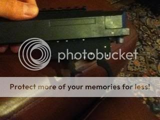

Trigger at rest.

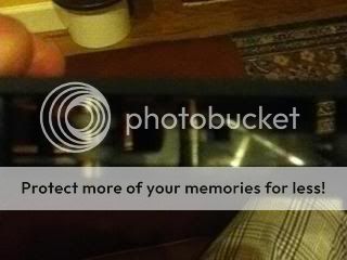

Trigger pulled.
I have 2 different springs, 450 fps and 550 fps, for different field limits. Oddly, it seems as if, though the trigger pull is equally as light, the trigger disengagement distance feels a tad bitshorter with the 550 fps spring (PDI APS 240) than with the 450 fps spring (stock spring). At least, that's how it feels. It's probably because of the bearing system, slipping more easily with heavier springs. The pull distance with the 550 fps spring actually feels relatively short, which isn't necessarily bad, just a little surprising.
