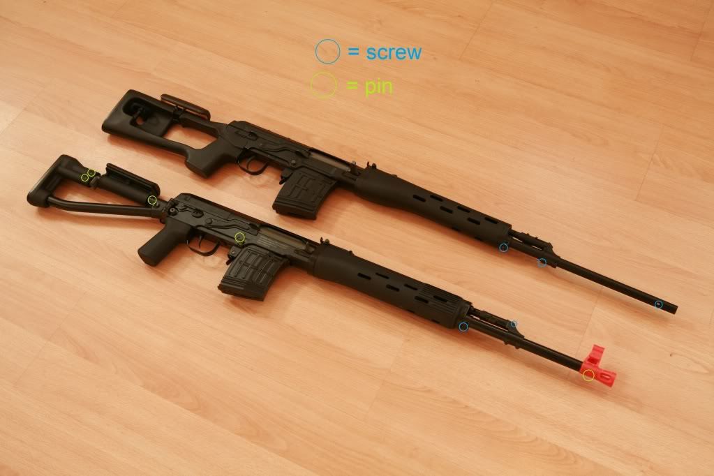

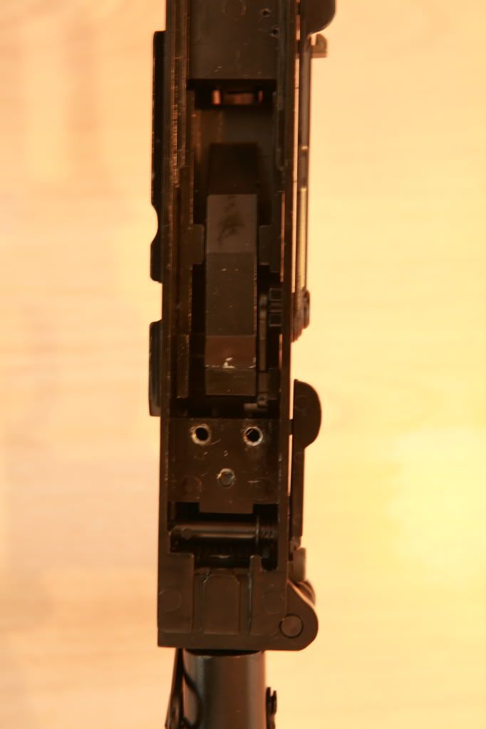

The first thing I noticed was that the SVD-S is much heavier than the SVD, despite the fact that the SVD-S has a folding stock. The handguard is noticeably chunkier and can be uncomfortable to some. But what really grits my teeth is that a lot of the rifle is pinned instead of screwed together. Take a look:
(I forgot to mark a screw on the SVD-S. There is a screw underneath the pistol grip, which holds the grip in place. No wobble.)

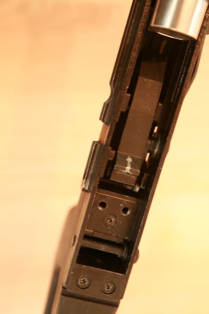

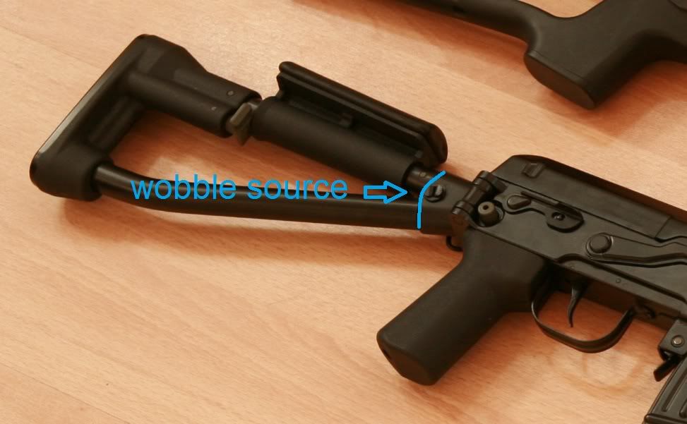

Dust covers are incompatible, as the SVD-S has different tabs at the front of the cover. The SVD dust cover has the stamped ribs while the SVD-S dust cover is more geometric. The lever that lets one remove the cover is also different. There is a spring on the inside of the receiver, which makes sure that the lever does not become unlatched. The stock has a terrible wobble, which doesn't appear to be fixable. The source of the wobble is not where the stock latches onto the receiver, which appears to be solid. See here:
Other than the stock, the rest of the rifle is wobble free.

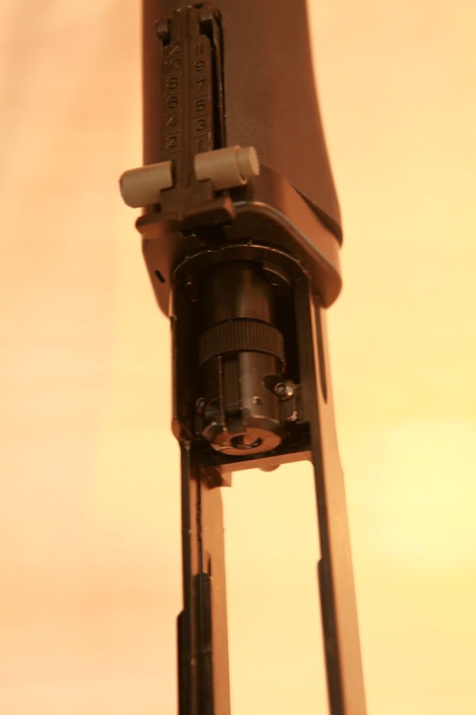

The hopup unit, which was the main reason why I bought the rifle, has a single textured wheel to adjust the hopup. If you turn the wheel to the max, it resets itself back to 0 hop, which can be handy as I'm never going to make it max hop. There is a distinct click when the hopup is reset. The unit is also bigger than the SVD unit.
The nub and rubber appear to be nothing special. Unlike the SVD, the SVD-S does not have a V-hop and uses VSR style buckings. It is additionally secured by two screws.

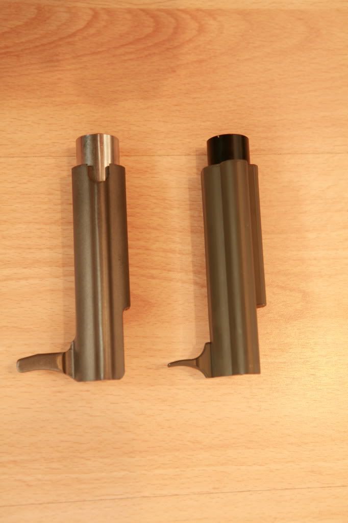

The bolt carriers also are incompatible. The SVD fits into the SVD-S receiver, but is unstable and will not chamber a round because the SVD-S hop up unit is too large. Conversely, The SVD-S bolt carrier is too big for the SVD.

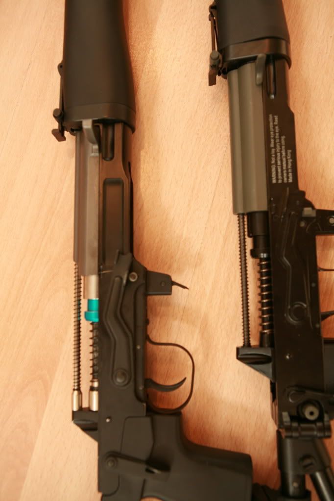

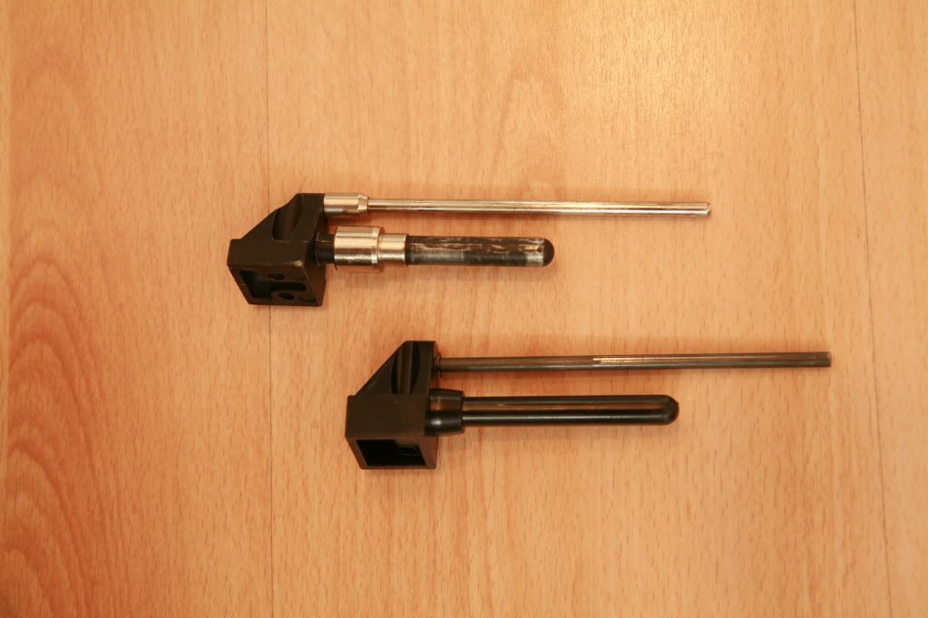

The spring guides and the screws that secure them are also different and incompatible. Watch out when you take out the spring guide because only the screws are keeping it from sliding out of place. I wouldn't worry though, it's solid. They both take elongated AEG springs.

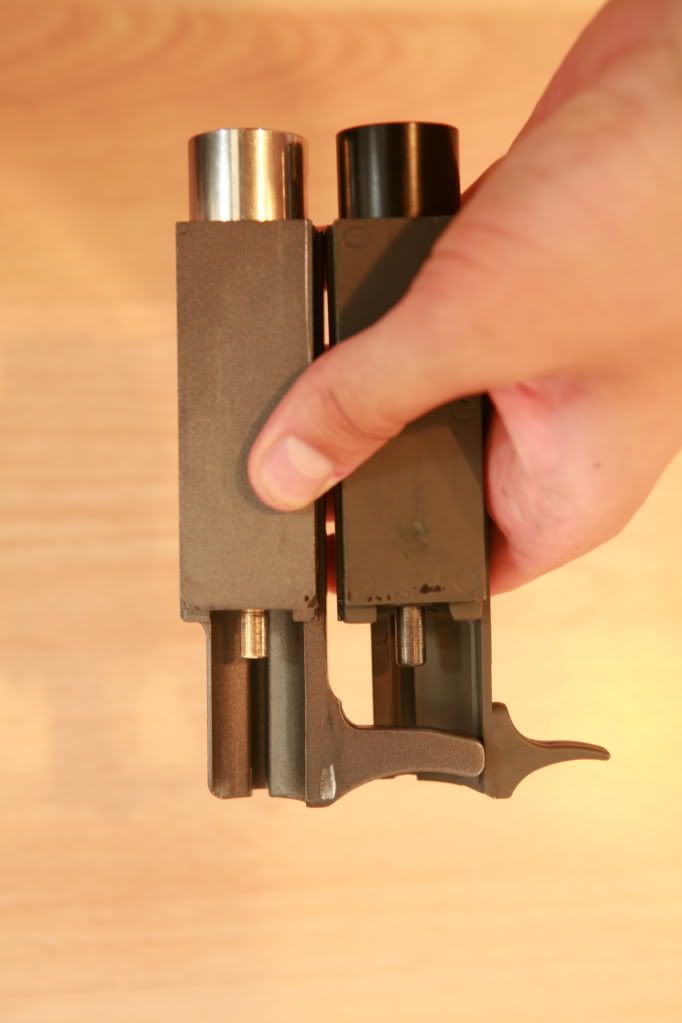

Trigger sears are compatible. However, the A&K sear sometimes did not cock in the SVD-S.
A&K SVD
Aftermath SVD-S

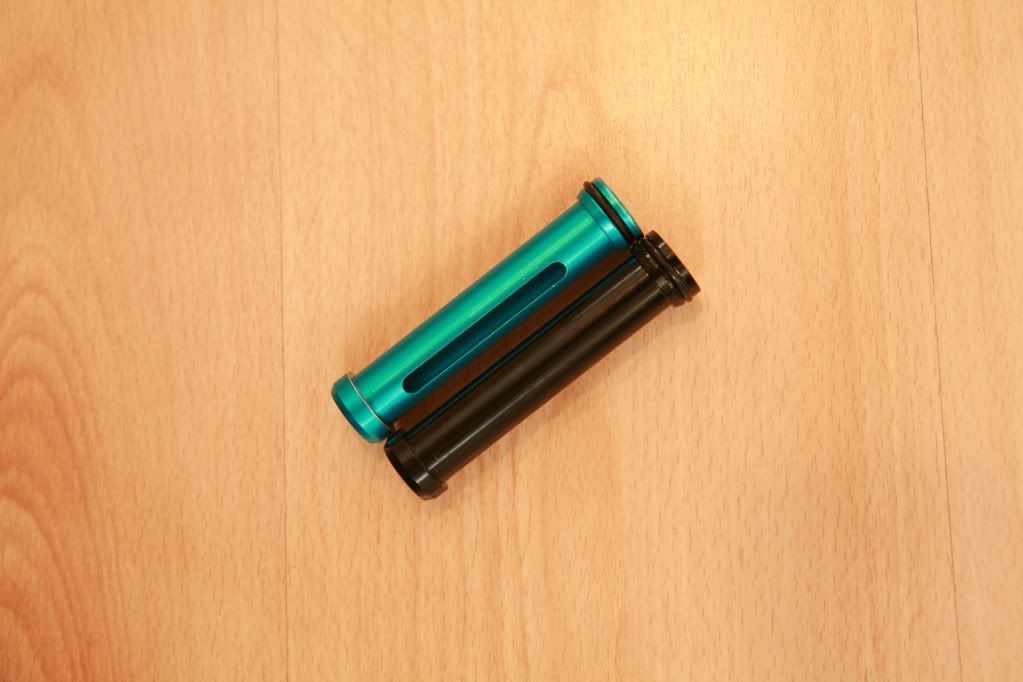

The pistons are cross compatible. However, the SVD-S piston does not have lightening cuts along the shaft.

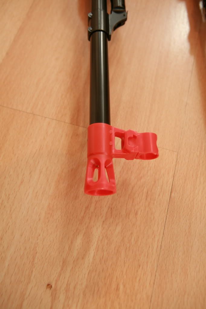

The pin inside the flash hider is glued in there. I could not remove it without completely destroying and melting the front sight, so now I have a front sightless rifle.

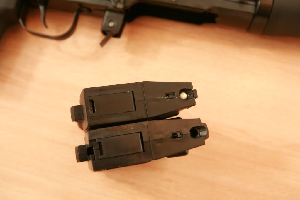

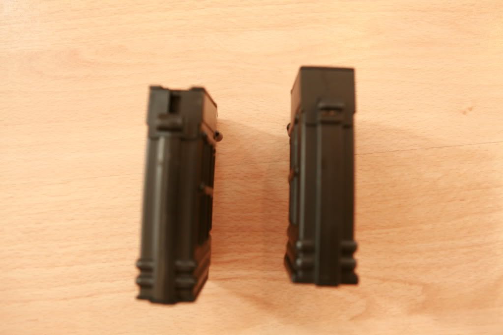

Magazines are also incompatible. The lips are different. However, I'm sure with some filing, the SVD magazines can fit into the SVD-S receiver. The mag with the "bb" is the A&K.
A&K SVD
Aftermath SVD-S
