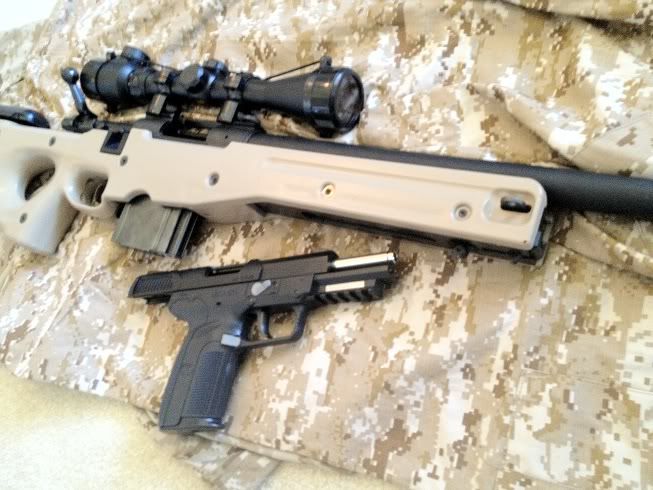

A little background on the gun:
M700 AICS, Tan, bought Summer 2010
Completely stock
She's served me well. Never had a mag leak, shoots incredibly accurately. It shoots hard, even though it is not a PCS:
This is the bolt http://i174.photobucket.com/albums/w107/swordfish1227/02a5610a.jpg
One quick question here - I have read that the post ban long mags only have one chamber in them - mine definitely has 2. Does this mean I have a preban mag in a post ban gun?
The gun and my TM 5-7 sidearm:
http://i174.photobucket.com/albums/w107/swordfish1227/IMG_0031.jpg
