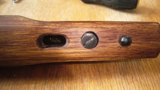

the stain on the wood part of the stock looks like it was done with gravy but is cut well enough to fit the working part of the rifle in I might just refinish it.
