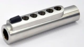

Well I haven't done it... But I'd suggest to get a ported barrel and then cut the slide to accept it.
Something like this
It would be easier to that.
