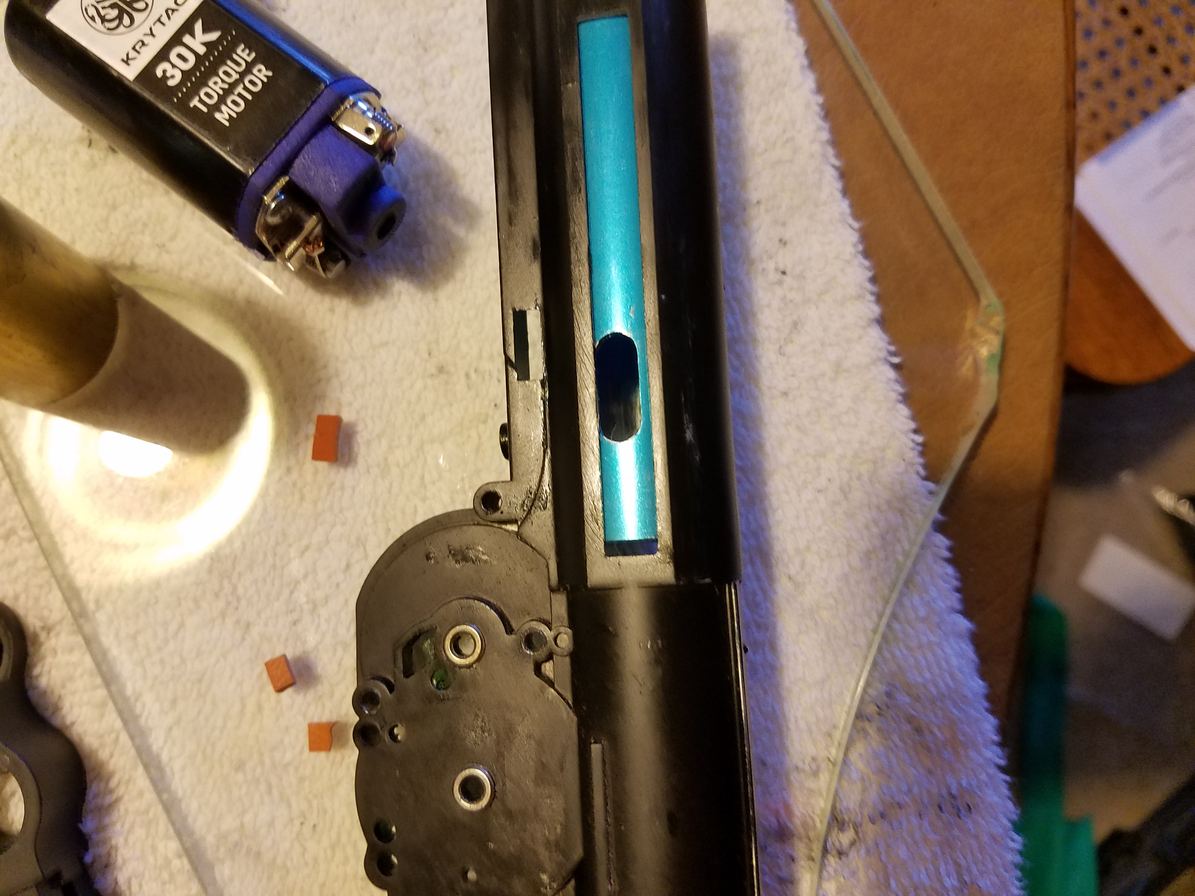

I have ordered a new nozzle with orings to help. But still abit worried about opening geatbox now. If the anti reversal was not working what would that do? Ive attached a photo of my old case with the window cut so i can make sure the piston is lined up.

That is not the proper cylinder for that gun. The cylinder should be filling that entire space.
Should look like this.

M14 cylinders are about 1mm longer then regular ones.
Here is a G&G cylinder in it.
