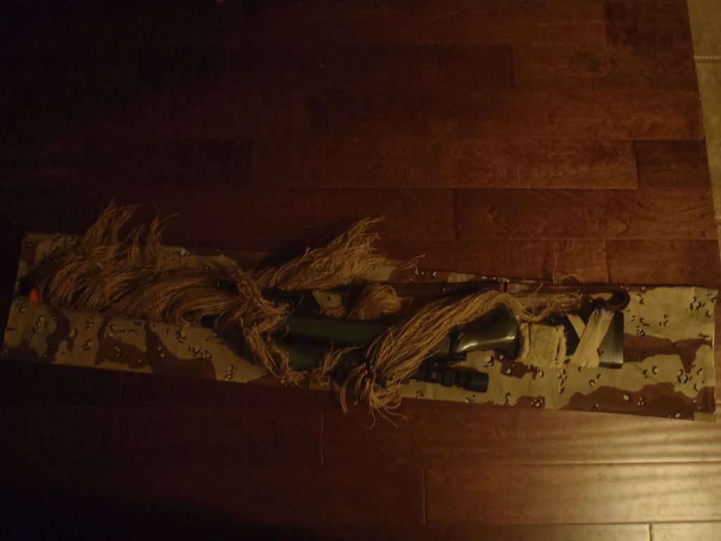

Once you have all your materials, the first thing to do is figure out how big you want your bag to be. If it is too big your rifle will bounce around inside, but if it is too small it won't fit. For my bar10, I cut the duck cloth 47"x23". Remember you will be taking off an inch or two on every side because you sew the edges together then turn the whole thing right side out. Figure out how big you need it to be then add two inches. Cut the lining to the same size as the shell (duck cloth).
If you use a foam sheet or some other thick padding, cut it two inches shorter than you cut the shell. If it is thick like my 1/4" foam sheet, you will want to keep it suspended between the lining and the shell. If you tried to sew the foam down it would be very hard to do, especially on a sewing machine.
Once you have the shell cut to size, sew your handle on. I sewed it to the center, not realizing the center of balance on the rifle is way off center. To counteract this I added a pocket to the side opposite the zipper. If I put my stock heavy bar10 in barrel first, it will tilt backward, so if I add a bag of bbs, my mag, and a speed loader to the pocket in the front, it will balance it out. If you have a barrel heavy rifle, add the pocket to the side of the bag the stock will be facing.
You don't need to add a pocket, but it's a good idea and will make your bag look better. I modeled mine after the pocket on my cargo jeans. It is made out of some extra duck cloth I had after cutting the shell. It holds a full bag of 4000 bbs, my bar10 mag, and my speed loader. If I could go back I would have made it larger, or at least made a second one. I would have also added the shoulder straps from the back pack. Once you sew the bag together there is no going back to add more pockets. You need to sew everything to the shell so once the liner is in there, you're out of luck.
After you have everything attached to the shell, you can sew the zipper on. The zipper from the book bag isn't that long, so I couldn't make it go all the way around to open it and use it like a mat. My method is to just slide the rifle in.
Remember to keep the bag inside out from now on. You will be turning it back right side out after it is all finished.
Once you have everything sewn together and turned inside out, give everything a check to make sure it is all secure. You don't want it ripping on you as you are carrying your rifle somewhere important, and have it fall out and break. Yank the handle, tug on the seams, pull on the pockets, and generally give it a bit of a beating. If something fails, re-sew, reinforce it and try again. If it's all holding up, then put your rifle in and you're set to take it to the next game!
