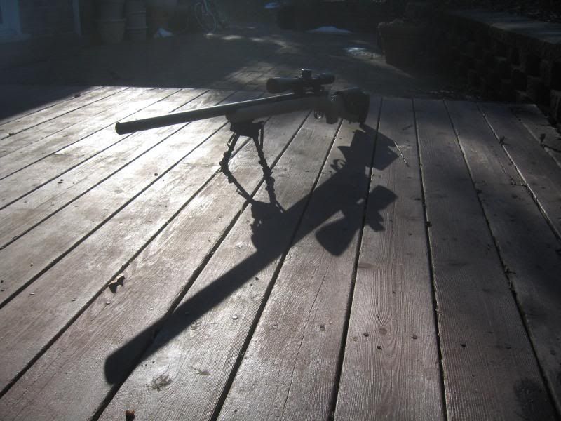

Classic Army M24
This started as a completely stock CA M24. It's now been fitted to the hilt with aftermarket internals. It took a lot of time and certainly a lot of cash, more than I'd like to even think about. But it's mostly done now. Shoots 525 consistently, here is what's inside:
-CA M24 civilian
-PSS2 Teflon cylinder
-PSS2 cylinder head pro
-PSS2 3-element piston
-PSS2 red piston head
-PSS2 7/9mm steel bearing spring guide
-PSS2 zero trigger
-PSS2 steel bolt handle
-PDI SP150
-PDI M24 hopup chamber
-KM TN teflon coated .04 barrel

Classic Army M24
-CA M24 civilian
-PSS2 zero trigger
-PDI SP150
