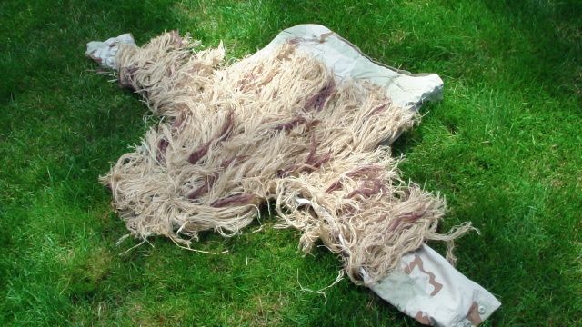

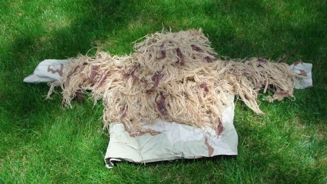

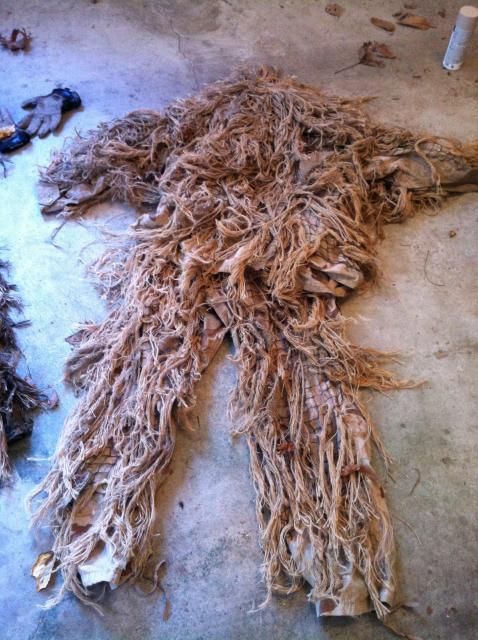

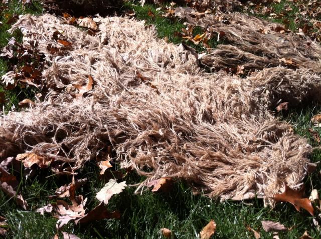

I am going to throw some pictures up as to what I have done in the past. Let me know if you were thinking anything along these lines. The ones I am posting seem to be something that can be rocked in Texas environment. Most pics incorporate a boonie hat unless otherwise specified.
The first suit below has coverage on the back of the BDU, as well as the arms, and up the sides of the collar over to the front side about 4 inches from the neck (on each side) to allow for total coverage while in prone. Also coverage on pants on backside only, as well as all of boonie covered.
Below is used with battle belt: Built to be used with one
Hope that gives you some ideas. I have plenty of more pics to give you some inspiration and ideas.

Thank you Fuzzywolly, I am glad there are helpful people on this forum! I liked the first picture, the one with total back coverage, back arm coverage, and with the bonnie. The ghillie suit I would want should be used for stalking, so it would match the first one except with more upper chest coverage, more arm coverage, and more leg coverage. I would like to be concealed in a low crouch stalk. I would like to know what part of Texas your in to see if your climate matches mine. I live in southeast Texas. Also if you can link me up with a guide on how to make a ghillie suit. I was thinking about the ATACS FG as a base? Thanks.
Edit: I would like to implant a battlebelt/suspenders. Staying light and quick but having enough equipment to survive.
When you are wearing the suit in the first picture, the jute hangs down and actually covers more area than one would expect. I actually cut the netting so that it isn't just on the back of the BDU. Picture laying the BDU facing down, back facing up. When you attach netting on the arms, on just the back side, you won't get quality coverage. I actually have excess netting that I let hang around until after the glue dries on the netting on the backside of arms. Then the excess netting is pulled reasonably tight over the top of the arm to the other side. While the whole arm is not covered, it is just enough to allow for great coverage in prone as well as when stalking. I wish I had a pic on me that shows this, but hopefully this gives you an idea of what I do. Cause it sounds a lot like what you are going for.
As for the battle belt, leave the bottom portion like in the last pic without netting. Whill make it easy to wear but even with jute/netting it is still comfortable.
