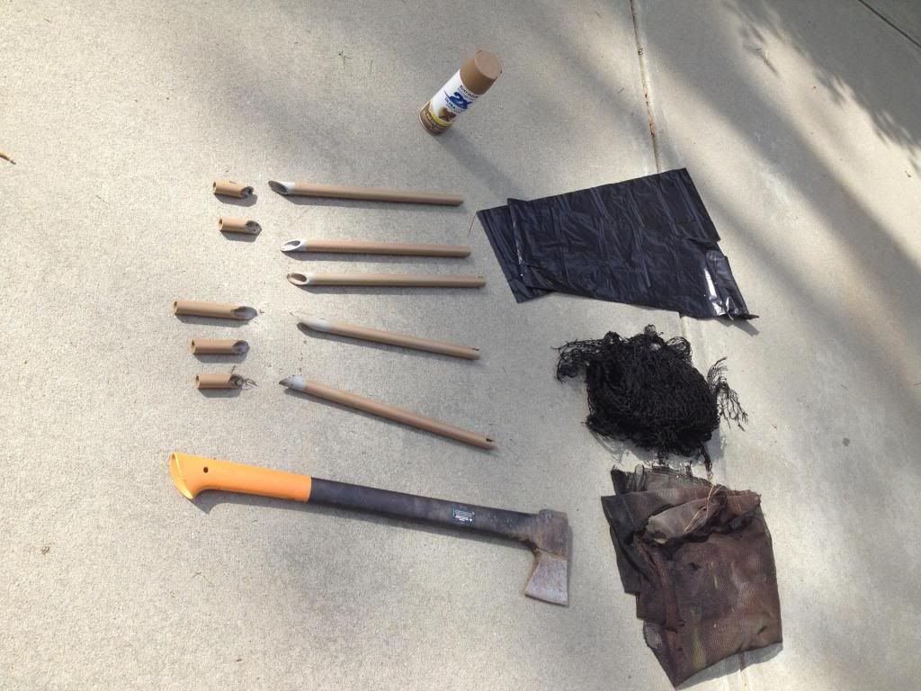

This is a simple list of all the items you need
- At least a 7x7 foot piece of netting (This is your roof)
- 6-8 PVC ground stakes (See below for construction)
- 2-4 black trash bags (waterproofing)
- An axe, E-tool, machete, or knife (digging and pounding the stakes)
- Mesh (optional, this covers up the small front opening)
- Spray paint in whatever colors work for your environment (Finishing touches)
- Branch clippers (Optional, for cutting additional loopholes for observation)

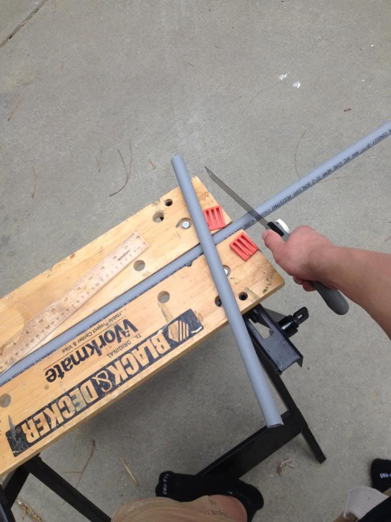

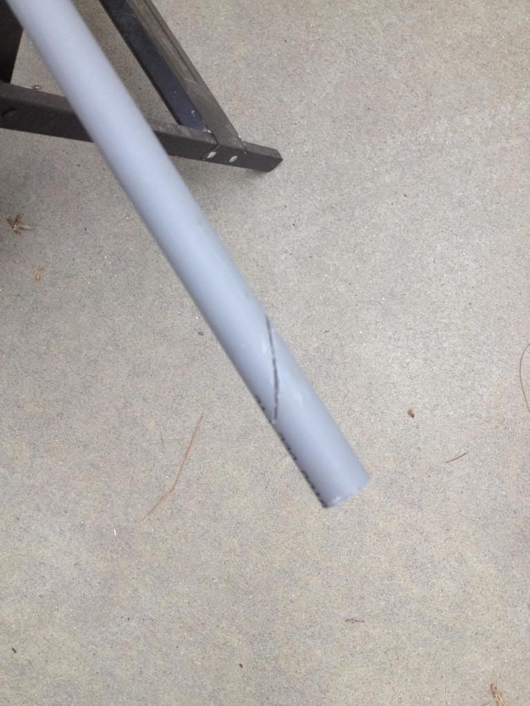

1- You will need at least 6 feet of ½ inch PVC pipe. I got 10 ft. for $1.69 at Lowes.
2- Cut the pipe into approximately 12 inch sections, and cut as many as you want

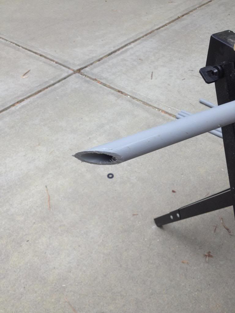

3- Make an angled cut about 2 inches in, so that you have a sharp end to drive into the ground. No, we are not making Vietnam Era Punji Stakes.
4- Hold onto the little end piece you get after you cut, these serve as mini stakes for little adjustments.

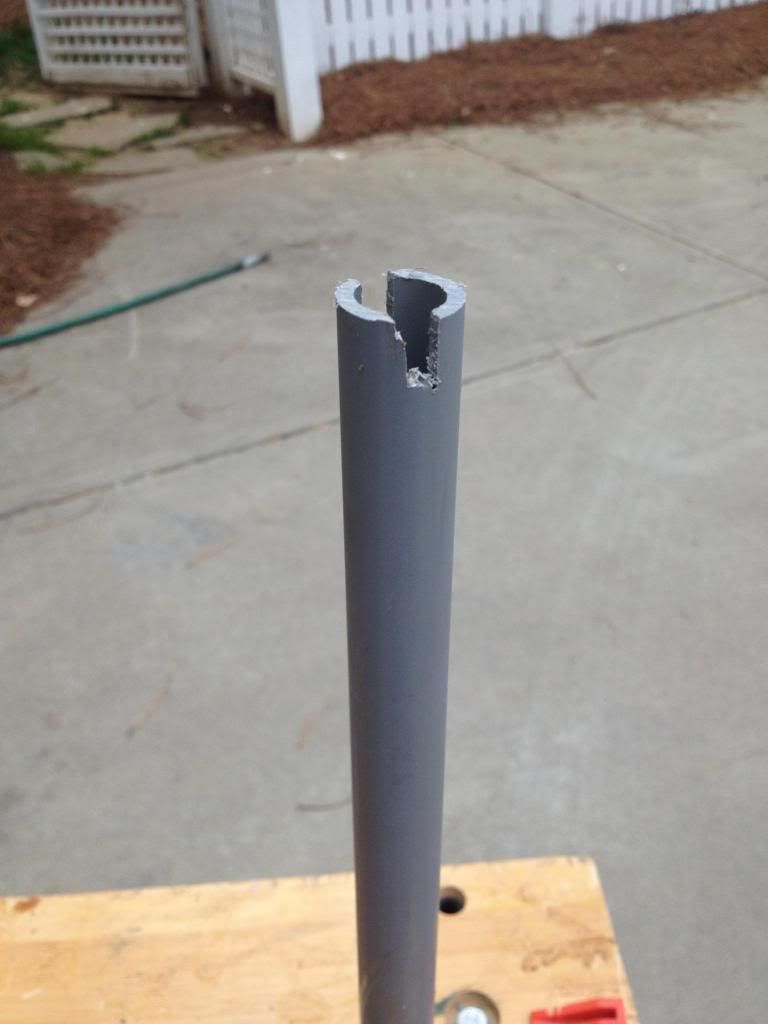

5- Cut a notch into the top of the pipe (non-sharp side) so that you can hang netting from it when you stab them into the ground.

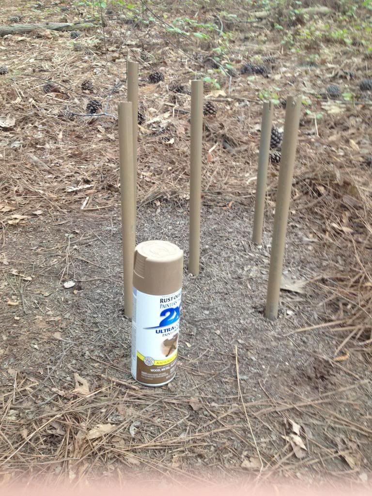

6- Paint them a nice forest floor brown or green to match your environment.
7- Repeat until you have at least 6-8

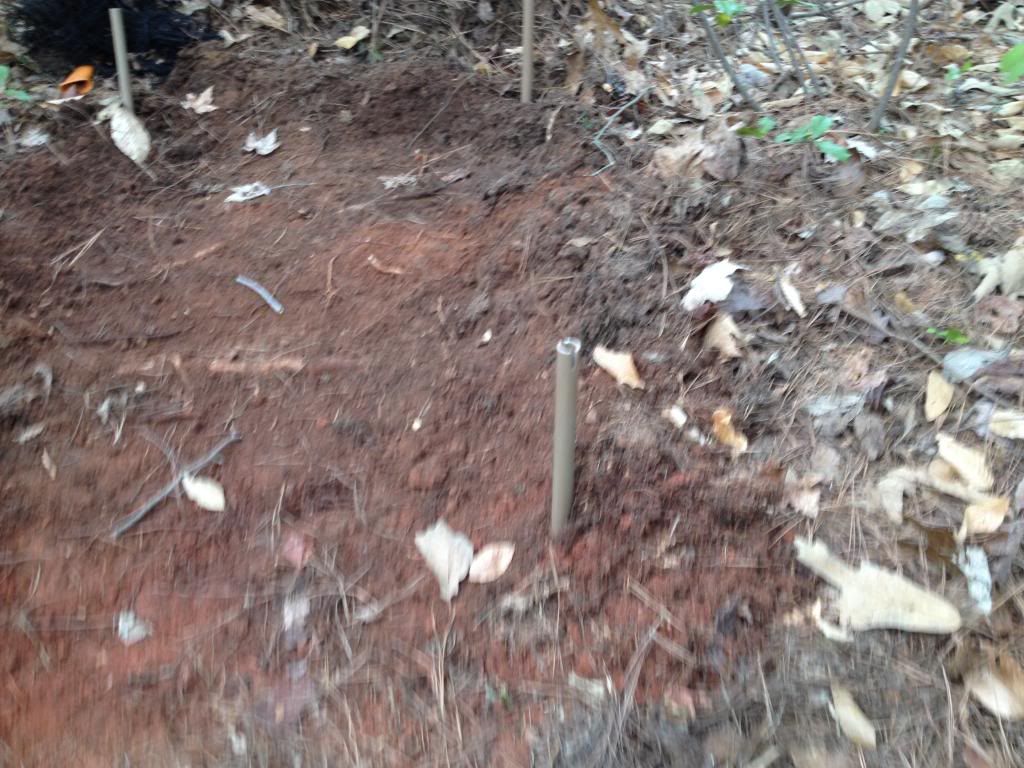

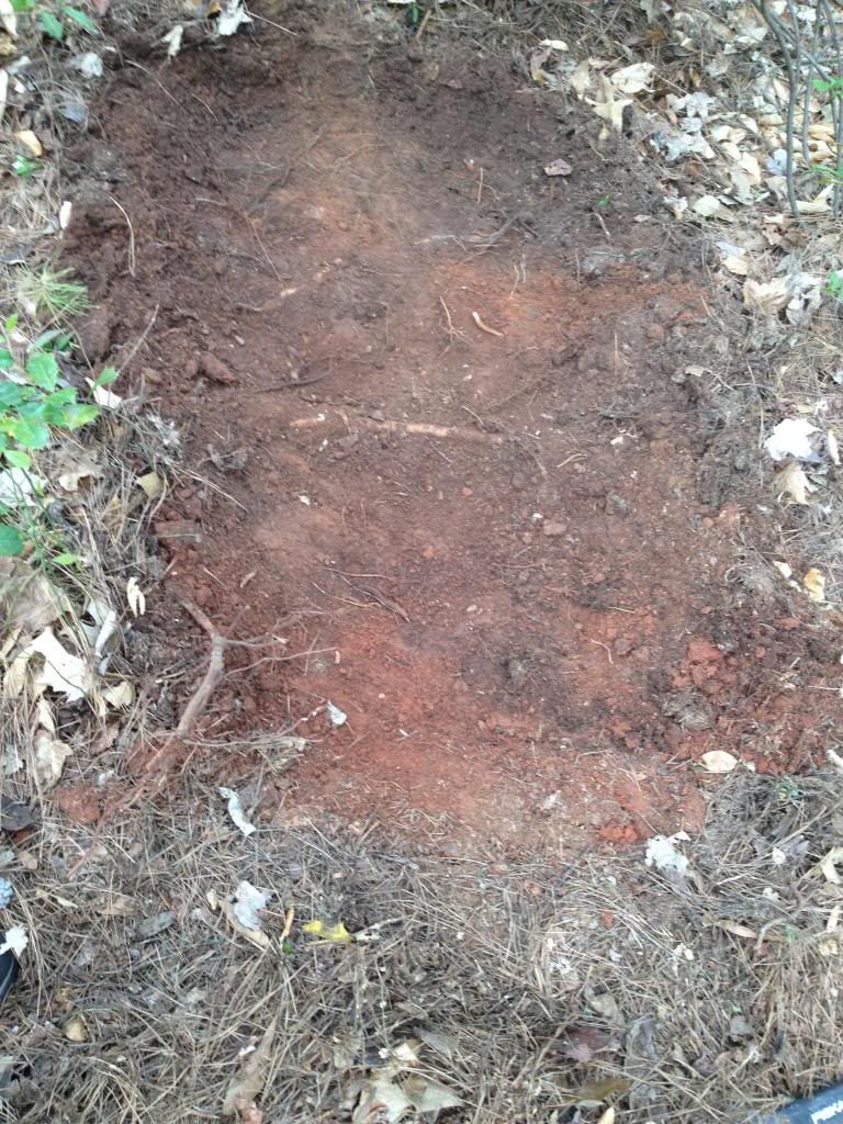

1- First, we must move into the area and clear the brush where we will build our hide. Sweep the brush away to the edges of your hide area, and hold onto it, you can use it for camo later.
2- Once you have cleared it, draw the outline of your hide with your cutting tool. This will help to keep you enclosed in your hide when you dig.
3- CHOP! Chop the ground inside your hide outline. Make angled cuts one way until you cover the entire outline, then make angled cuts the opposite way. This is the most difficult part, but it is very important as it brings you below the surface level.
4- Once you have loosened up the ground like some ground beef, get dirty! We are snipers anyways, who cares about the dirt. Use your hands (or E-tool) to move the dirt from the insides to the edge, so that you get a depression on the inside, and a little wall on the outside. It may not seem like much, but when you get lit up, every inch counts.

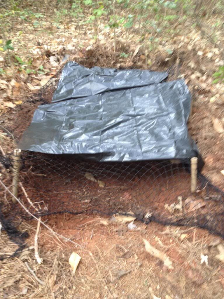

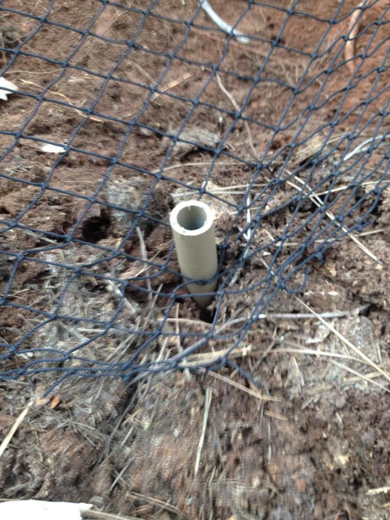

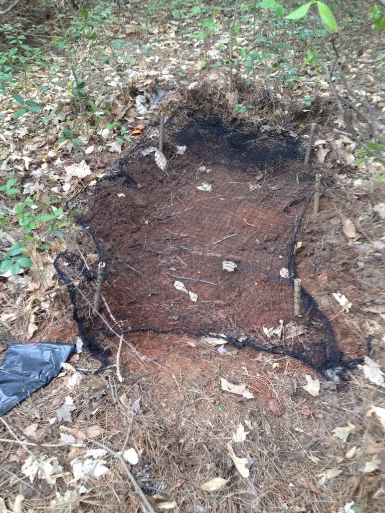

5- Drive 4 stakes into the ground, 1 in each corner. Push them 3-4 inches past where your sharp point ends to lower your silhouette, and to ensure stability. Axes are nice here, as you can use the flat side to hit the stakes in.
6- Hang your netting over these stakes, putting the small rope of the net into the notches. Be sure to leave overlap on each side for additional stakes and to make the netting slope to the ground, not drop off.
7- You can now use your additional stakes and the mini stakes to pull the sides tight, to the ground, and make adjustments.
8- Now, take your trash bags and lay them over top of the netting. This will help to make the hide waterproof in case you are playing in very rainy conditions, or you don't want your precious BDUs to get wet (please don't let that be the reason why)

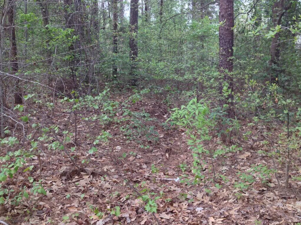

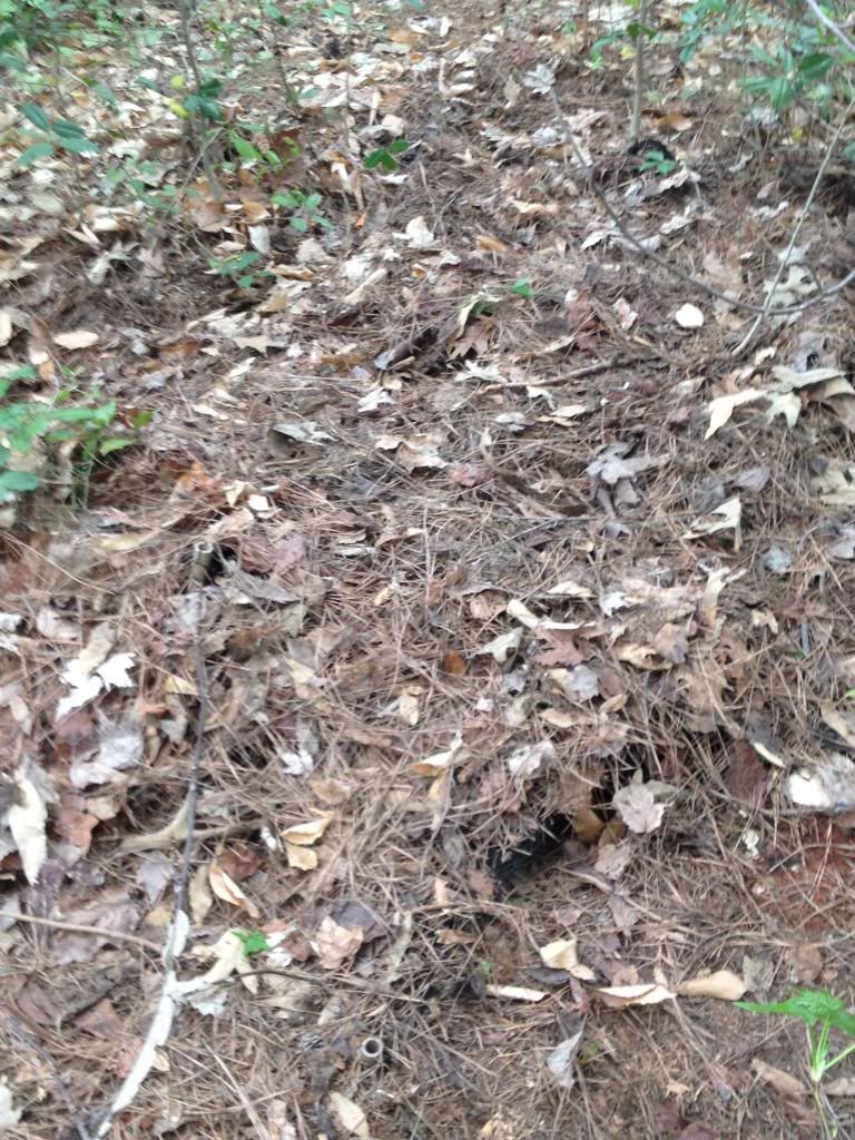

Once we have our base, we can cover the whole thing in veg. Take the veg from the initial clearing and lay that on top. Then, move around and grab more veg.
Don't grab it from 1 point, as that will leave an empty spot that is painfully obvious. Also, vary your location and veg so that you get a diverse supply of veg. Cover as much as you can before the roof sags too low and it becomes obvious, then you can use spray-paint to add the finishing touches and cover tiny open areas.

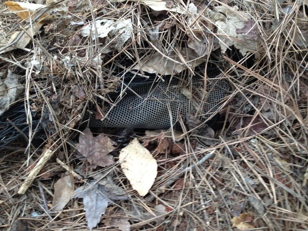

-You may want to add mesh to the open front area to prevent a black hole that screams "HERE I AM! COME KILL ME" and touch that up with paint as well.
After this, your gorgeous hide is finished, and you may enter from the front to begin your work.
