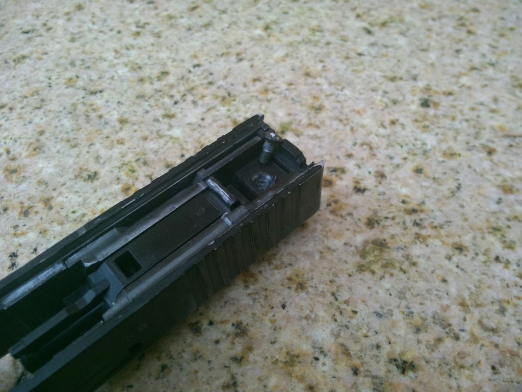

3:
This was another cause of my gun getting stuck half way when cycling and as a result would spew all the gas out (yes I went through A LOT of gas before I fixed this)
The Fix: For what ever reason the screw holding the blow back unit into the slide would come lose after each shot. I fixed this rather easy just by adding some teflon tape to the screw making it secure from loosening.

3:
