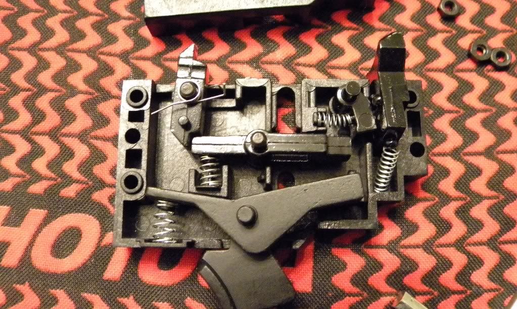

I dont know if there is an aftermarket for the trigger set yet. I had heard that it works with APSII parts, and the PSS parts that I added were for the APSII (piston, head etc.) the best I could find in researching it on the internet before doing the upgrades were pictures that someone took when opening their trigger set. I dont know what the APSII trigger set looks like, so I dont know if they are interchangeable. Here are the stock pics that I found, Ill post some target shots later tonight (that is assuming that I can get it on paper

EDIT: This is for Woogie, while I was looking around trying to find a spring comparison chart I found this review on ASR: http://www.airsoftretreat.com/reviews/showproduct.php?product=384. its pretty good, it says that the trigger assembly is interchangeable with the Well SR2... seeing as it is a Well gun, i dont know if there are even upgraded aftermarket parts for it, but its a good lead.
correction: Maruzen SR2, not Well

I like the idea of adding an adjustable trigger. To add to that though, if I were to modify the sears... I would just fab my own. It wouldn't be too hard with some scrap high carbon bar stock, a dremel, some brass pins and JB weld. I would change the step on the piston sear to be more of a ~45 angle with a small vertical step on the bottom, sintead of face to face like that at 0. Just my 2c, but since I don't use this gun anymore I doubt I'll get to it.
