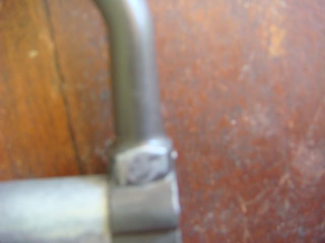

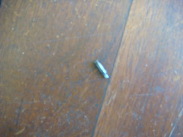

Step 2: Go get some sand paper. Now I did not have any, so you know what I used....A brick. Yep, just a normal ol piece of brick I had lying around. You will be using this to sand down the small silver metal piece. Why you ask?
The guarder's handle has a small hole where that little silver piece goes. It turns out, its way to small for the silver piece to slide in. You will need to sand down the hole thing. After lots of sanding, you will notice that the silver piece should slide in the handle's hole, and should stick out the other side.
Silver piece

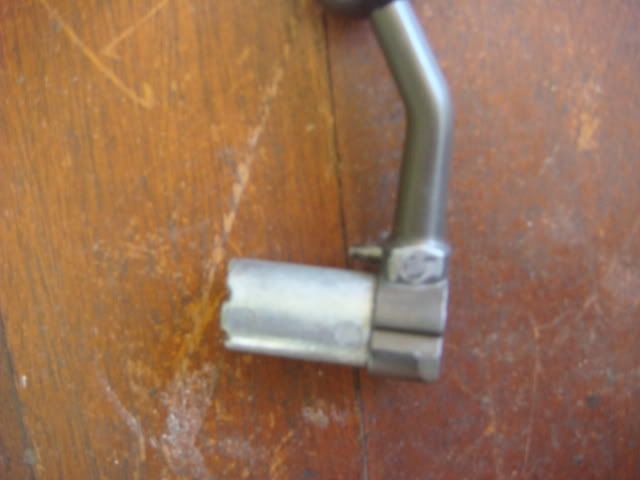

Silver piece going through the hole on the bolt handle
Silver piece sticking out the other side of the bolt handle
Keep in mind here, that this is not the actual guarder bolt handle. That is on my rifle at the moment, so I just used the stock bolt handle as a demonstration for you all

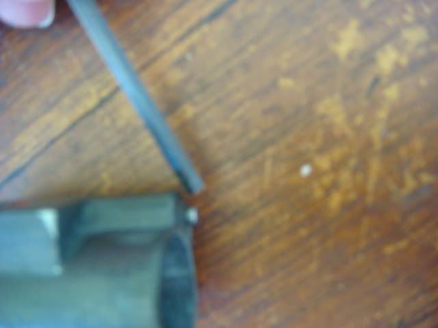

Step 3: Now that the silver piece has been sanded down, and fits through the handle's hole (so scientific)
, its time to sand down yet another part.
Step 4:
Notice where the allen wrench is pointing. That little piece needs to be sanded down on the sides to allow it to push through the small hole on the guarder bolt handle. This does not need to be sanded much, just alittle.
Step 5: Now give it a try. Put everything back together, and attach it to the rifle. Try cocking the rifle, and see if it works. If not, repeat steps 1-4. This took me a good couple of hours, so do not get frustrated if it does not work the first time.

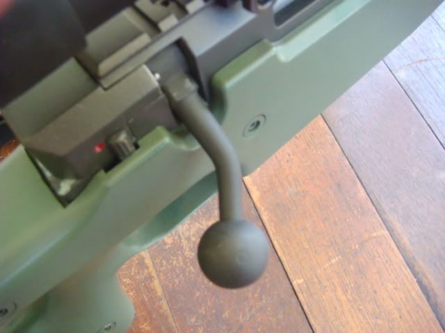

Here is a picture of the guarder bolt handle on my rifle
Here is a comparison between the stock bolt handle and guarder one.
Guarder on left, stock one on right.
Silver piece
Step 4:
