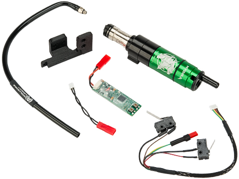

HPA is good, that'd let you get a cheap rifle and the barrel, bucking, and chamber.
I'd recommend the Wolverine BOLT, a 26/3000 tank, and whatever line and regulator. EPeS and the new Wolverine CAT5 regulators are supposed to be great, but they came out after I'd already bought a Polarstar MRS.

With one of my 6 inch tanks you'd spend $15 more on the tank and another $25 to buy a first stage regulator, and the regulator I listed you'd be able to get that all for $450, and it would completely fit in your gun.
I suggest you use your SSG10 a while, but do keep HPA in mind. If you got the Mancraft SDiK instead, you'd be able to get a full HPA loadout with my mini tanks for $313, which is pretty dang competitive if you add on a cheap base gun and some minor modifications.
