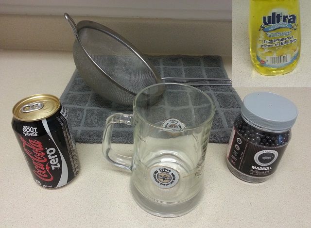

What you will need:
Container to wash in
BB's
Strainer
Towel or old sock
Dish soap
Suger free coke or cheap denture cleaner (coke has more acid then pepsi)
Step 1:
Gather your tools

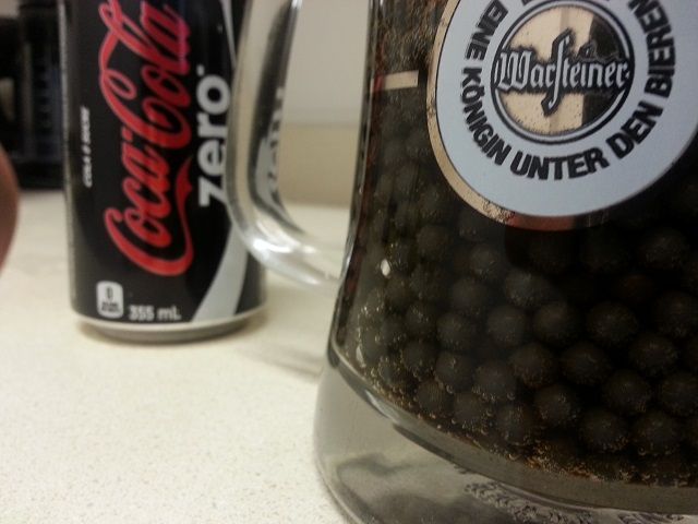

Put your BB's in the container and pour in the coke. You may have to do this slowly to allow for the coke/denture cleaner to filter down through them
p.s. warn you room mates not to drink it.
Step 3:
If your using coke: Wait 12 hours
If your using cheap denture cleaner: Wait 4 hours
Step 4:
Pour in water and flush out the coke/denture cleaner

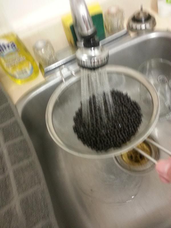

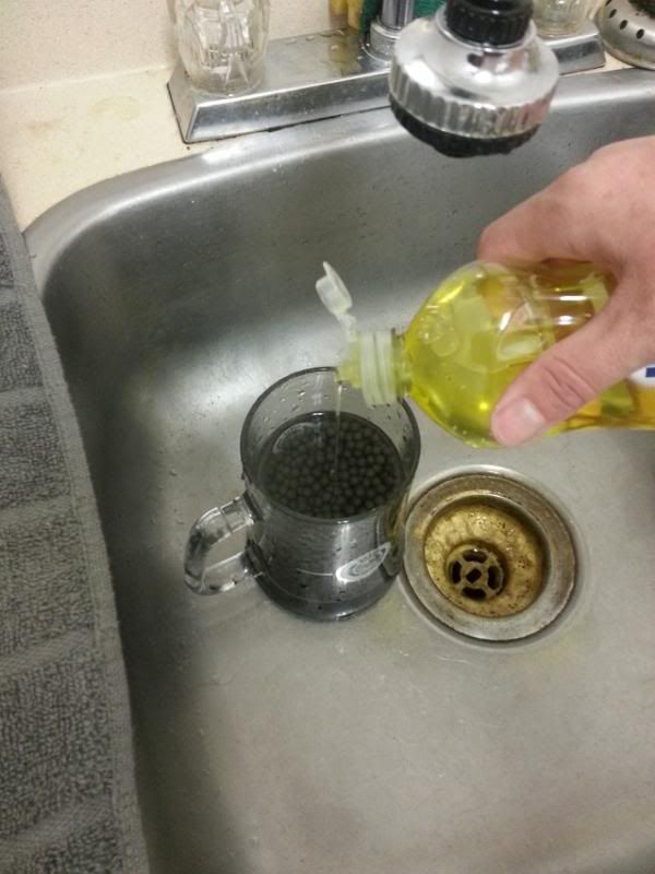

Add dish soap and mix it in, should only take 2 - 3 minutes
Step 6:
Rinse
