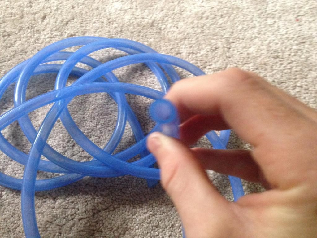

link where you purchased the silicone tubing material? im thinking about buying one and practicing making a r hop myself
go to: McMaster-Carr
Find the Search bar
Type this in it: 51135k17 and make sure the dimensions are 3/16" and 5/16"
Go here for pics: http://www.airsoftsniperforum.com/32-general-sniper-talk/9551-r-hop-source-material.html
Also it is good to practice with. Ive R-Hopped others guns at my local airsoft field because Ive become familiar with how it all works and how to do it.

Thanks for linking that, have been looking for the right tubing, and for about $10 for 10ft it sounds way better than paying $30 for 3 patches that I will fail horribly at.

I heard that PVC tubing that is used in fish tanks works as well .. anyone confirm this ?
Never heard of that. Might be, but Ide stick to the norm if I were you.
697 Posts
That tubing may not have the proper inner diameter. The reason the linked tubing is proper because it first of all works under the normal earthly climate, 0-100 degrees Fahrenheit, so you don't need to worry about it becoming rigid or anything, it will just keep the same flexibility consistently. Also the size of the tubing is perfect because once you sand down the sides and legs the inner diameter will be flush with your barrel, so you don't need to sand the inside down. But ya know, if you have enough time on you hands you may as well test it.
