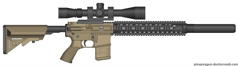

I plan on making an M110 SASS style DMR. I always liked it's design.
I just want to find a good base gun that can be upgraded to 460 fps w/ .2g without issues, house a 6.03 TBB, and resemble an M110. Plastic or metal body, doesn't really matter to me, as long as it won't break from normal wear and tear.
I've never built a DMR, so I really don't know where to begin.
EDIT: I did some looking around, evike in particular because I couldn't find what I wanted at ASGI, and found a good laundry list of items that could work.
G&G M4 Challenge Kit (Tan)
Madbull Dissipator 16" Outer barrel
Angel Custom 6.01 510mm tbb
Madbull Dragon 16.25 Free Float RIS
Prometheus Hard type Bucking
AIM 8mm Complete Gearbox Rear Wired (M130
Matrix High Torque Motor
M28 Silencer
2 50rd P-Mags (Tan)
Intellect 9.6v 1600mAh
What do you think?
If you want the links, I can post them
What it could end-up looking like:
5
^^ Sounds like a plan. ^^ please don't!
Looks nothing like a M110 SASS. M16 ris on your pimp drawing when a M110 takes a KAC RAS. I'm sure it's common knowledge that in the real gun (RIFLE!) world that a M110 is a 7.62 and Mk12's are 5.56, a smaller NATO round. The KWA SR12 was modeled a bit after a Mk12. For the love of....I really don't need the spec difference between a Mk12 and SR12. FULLY aware.
Not trying to be being mean about this, but you say you want a M110 SASS styled set up. I realize exact specs are probably not crucial and that you just want the over all look and feel of a M110. I fully understand you there, because I'm in your shoes. LOL.
