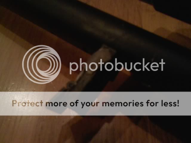

MS Paint Skills
The most important part to place your tape/epoxy is at the portion closest to the hop up chamber. If you miss this spot, the hop up chamber will continue to wiggle.
Here's mine. I used JB Weld.
Notice how I only put the JB Weld at the top of the mag catch, as I said before. Pretty? No. Effective? I have no wiggling whatsoever.

MS Paint Skills
