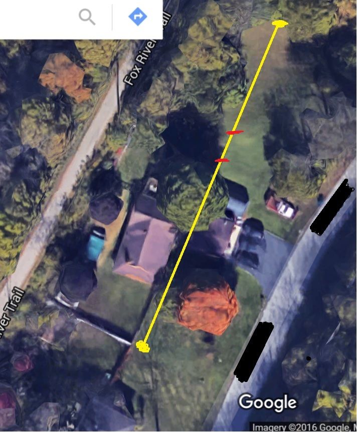

All but 1 part was a simple install. Only the hop-up chamber needed some fabricating to get to fit properly. As we know the barrel pulls out, with the new hop-up, it did not fit through the part that holds the barrel in place. Simple fix was to lightly sand down the plastic where the barrel gets put in. Didn't take much so would suggest lightly sanding and constantly checking to see when it finally fits.
I did not Teflon tape anything nor did I check air seal. Just installed parts then tested as is.
While I still don't have a chrono, have not been able to get the fps. I did however get to test fire the new components at my folks place which is surrounded by forest preserve. Still has the stock spring installed and was able to get about 250ft hits to a tree about 1ft wide. Now consistancy is not it's strong point. Shot about 50 or so shots, about half of them actually made the distance, the other half fell around 100ft.
Was using: 6mmProShop Pro-Series 6mm Premium High Grade High Strength Airsoft BBs - 0.32g White.
Also shot some : Matrix 0.40g "Sniper MAX Grade" 6mm Grey but could not see them.
Yellow line = 250ft approx
Red Lines = range where half dropped
Shot straight with none veering off right or left. Wind was near non existent, but was slightly sprinkling out. Will do some more fine tuning and possibly a stronger spring (if I remember 1tonnes guide correctly, think m150 is where I want to be for around 500fps). Note 500fps is our field limits for snipers, 400fps for everything else. so will get m140 and m150 so once i do get to chrono it, will have a couple options just in case.
So all in all, I'm currently pleased with the gun. Total cost thus far is at $375 (rounded up) including any shipping costs (new flash hider wasn't necessary but definitely looks a lot prettier with it). The scope is Matrix but wanted a scope that would look appropriately sized for this gun, and this one definitely fit the bill. Will add picture later :tup:
Any questions, just let me know.
