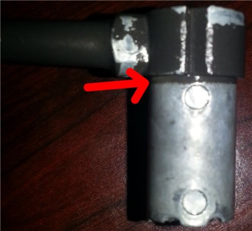

2) The next issue is that the hole in the bolt handle is off-center so when you try to reconnect the cylinder after flipping the bold handle, it won't fit. I measured it and a half inch drill bit should fix it, hopefully, and if all else fails, I'll use a file. *Finished mod*

I did some measurements on the bolt handle and the front of the bolt has a 12.2mm diameter hole while the smaller off-center hole on the other side is 11.92mm in diameter. I figured that a half inch drill bit that measured 12.9mm in diameter would work as long as I didn't drill all the way through, so I figured drilling only up to where the paint starts, starting from the smaller hole, should turn out perfect. I completed the process and everything worked spectacularly.
