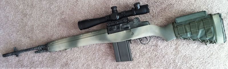

Well it's not a Kart, TM, or CYMA M14, but my G&G M14 is finally built and up and running.
Why I'm mentioning this, is I have a M120 spring. Followed the Longrange AEG Holy Grail tips here on this forum. Installed a 534mm Systema barrel, PDI bucking, Deepfire aluminum AUG nozzle and I'm able to hit a normal size trash can at approx 240-250ft.
I need to do some more test shooting with it tonight. Mainly because I just installed the PDI bucking last night and the Sun was starting to set, so visibility was fading by the minute.
I could visible see the bb's and here the whack sound as it hit the plastic garbage can.
I had more range with the stock bucking and SCS nub, but the bb's climbed up too much after 220-230ft.
EDGI's are nice. PDI's are better. Not by much. Just noticed more consistency with PDI, but EDGI's have the second tightest shot group. The SYSTEMA I got a couple weeks ago is impressing me, but that's one brand I have little experience with. We will see after some more uses if I'm still amazed at how it's shooting.
My G&G was a bit difficult at first. Stock it shot about 160ft and was less than impressive. Some fine tuning and it's turning heads now.

Just got the scope and mount in today. Looking to hopefully start a post about my G&G M14 here soon.
awagg - not sure what M14 brand you have. Did not see it above, but skimmed over a few areas.
