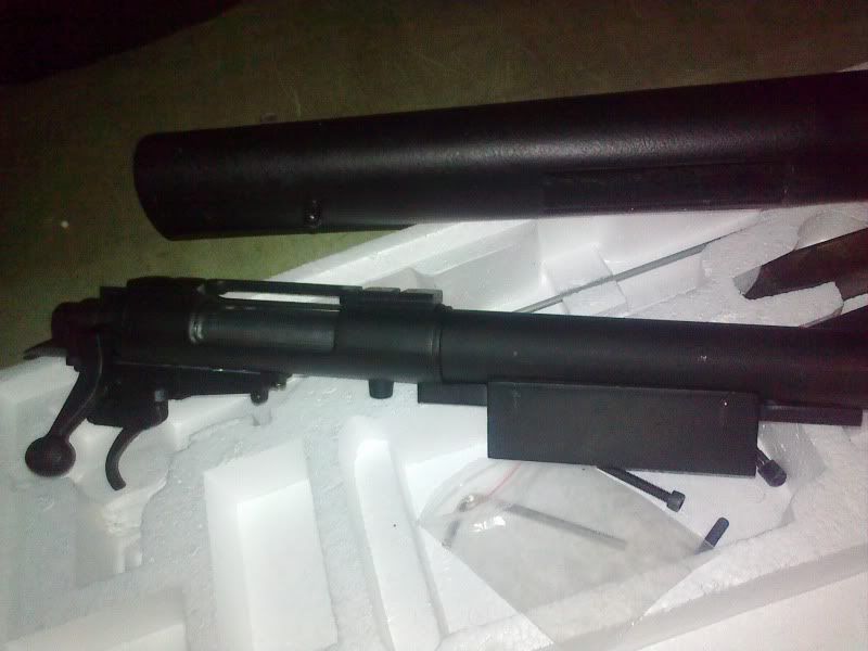

I recently bought an m24(i think this is the same with the Echo1 m28 sold in the United STates) and to have a better understanding of the gun, I took it apart and compared it with various Bar10 / VSs stock parts i have lying around. This is my first ever review of a gun, so please bear with me
Part 1: the externals

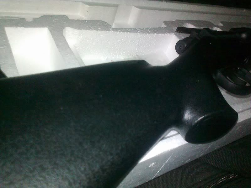

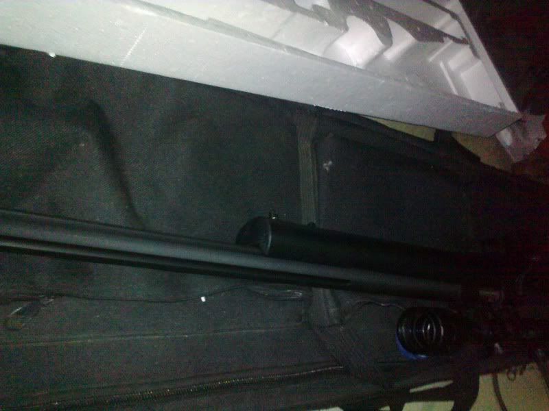

The gun's stock is built from plastic and is quite heave. It does have a nice feel on it, as it has that scaly design, as compared to the flat look on the VSR / Bar10 models. When apart, the butt of the stock is very heavy, due to the retractable butt pad assembly, but when put together with the outer barrel, the weight is more balanced
The outer barrel is fluted, and is constructed out of solid metal. The construction, I think is more solid than that of the bar10. It also has a nifty magwell made out of china metal as well, which is think is good enough to lock in a very cheap a$$ magazine.
The gun comes with a rail interface, to put in those scopes as well. sellers here in the Philippines did not include the bipod and the extra mag that you guys get from echo1.
Overall externals, I would say is quite good. It has a very nice heavy feel on the gun, much like the m14 aeg in weight. I put in a bushnell 4-12x40 I have lying around, and maybe i'll be painting it moss green or something to that line. I also ordered gun wraps along with my ghillie, so we'll see how it looks like wrapped and not wrapped.

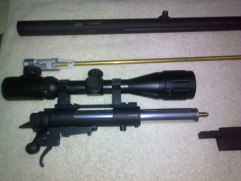

part2: The Internals

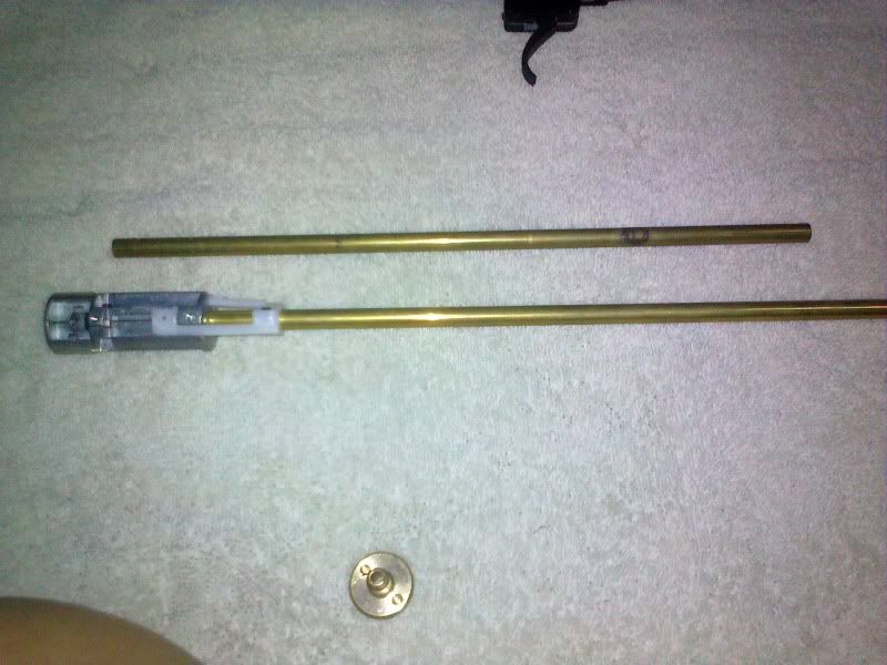

After a few shots I decided to take the rifle apart to look at the internals. OTB, it shot around 500fps, so I was so curious on how it shot that strong, considering its stock setup.
I made few comparisons on parts from my old Bar 10 (sold it off for this baby. :))

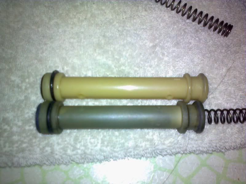

Piston Body Construction:
Pretty much, the m24 and the bar 10 has the same piston body construction. made out of plastic and the only difference is that the m24 is a bit longer by a centimeter.
m24 on top, bar10 piston below

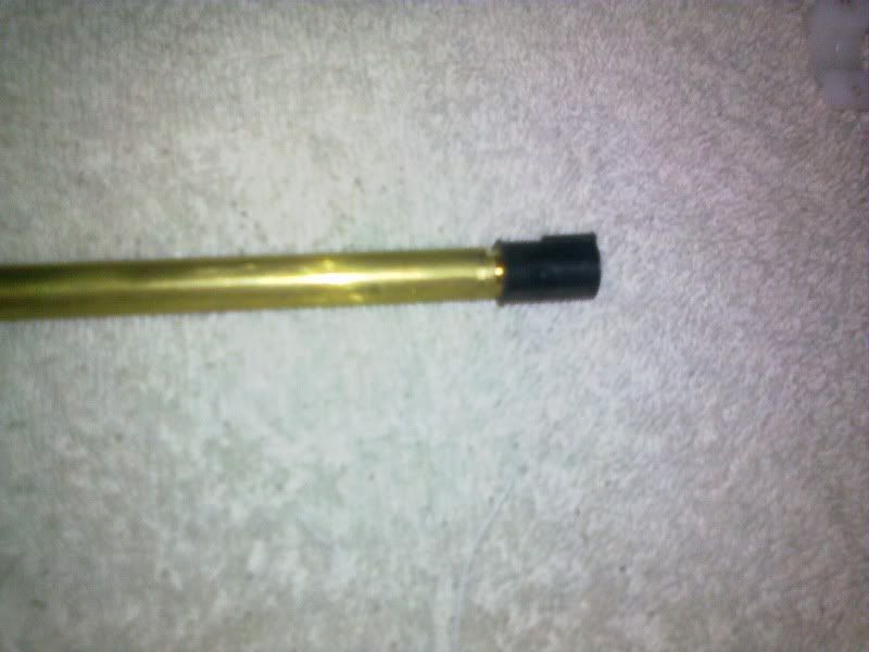

Hop Assembly and Inner barrel:

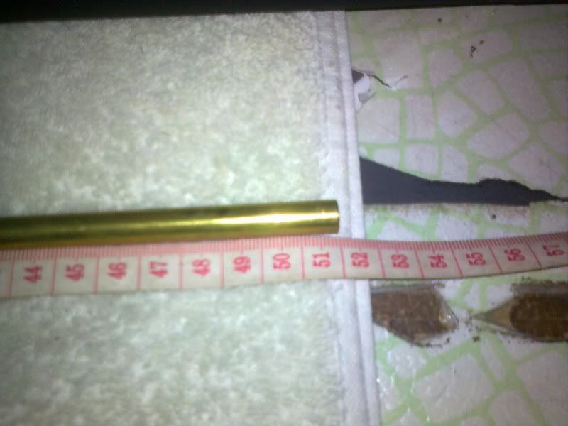

Hop assembly is pretty much VSR configuration, but what i love on this gun is that it comes with a 510mm inner barrel, which most sites say has a 6.03 inner diameter. I dont have a gadget to measure it, so I wont be discussing it that much.
Hop bucking is also the same with bar 10's. i had it washed already with warm soapy water as well.

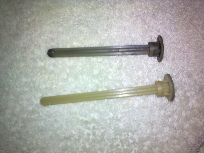

Spring Guide:
Much like the piston body, m24 SG is slight longer.
The trigger assembly does look like VSR configuration, and i'll be upgrading it using machine tooled steel. (If any of you guys know EdGi, http://edgicustom.blogspot.com/2008/01/jg-bar-10-upgrades.html) Im going to order his parts, since he works at next building where I work from. :)
