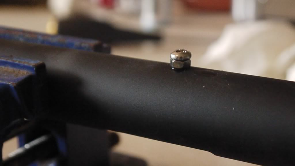

Here's my TDC adjuster! I will be replacing the screw with a shorter hex screw too and I will put a spring on. This is just for the video tutorial! The photos below are two screen shots from the video:
I just use the 430mm inner barrel in the 690mm outer. It works fine. I was going to use a normal lengthed outer barrel and a suppressor but the longer outer barrel works as a suppressor too so I'm not going to trouble PDI by having them pay for posting to and from Japan just so I can swap barrels.
Yeah, it muffles the sound a lot! I was worried about the bb bouncing about inside and not coming out the end cap but Wolfgeorge convinced me that if I had barrel spacers it will be fine, and it is! ;)
