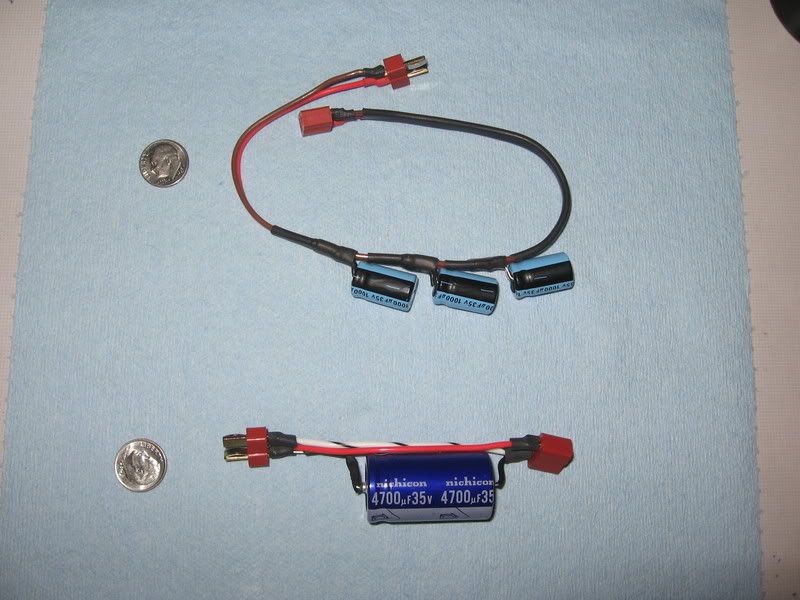

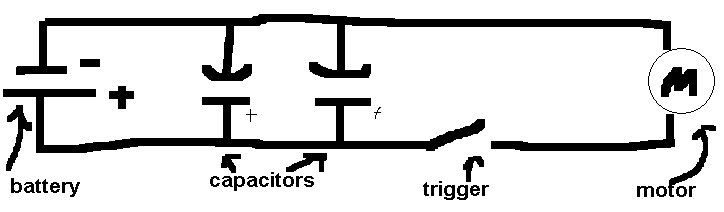

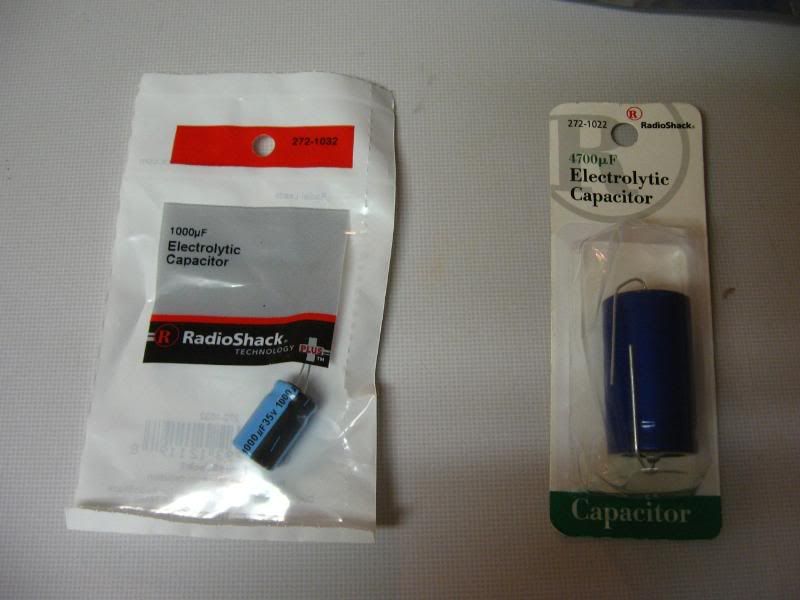

Capacitor BAnks
Capacitor banks Can improve your trigger response and rate of fire.
Electrolytic Capacitors store energy and release it on demand. This will fill in voltage drops seen when you initially pull the trigger, and when the AEG is cycling through some shots.
When the voltage drops, the capacitor releases its stored energy and helps smooth out the current. once the voltage drop is gone, the capacitors fill up once again.
The improvement is nominal though, and to get a noticable difference you need a pretty large bank. Not all AEG's have room for this so keep that in mind.
If you can fit them in though, there really is no disadvantage to using them.
to install a capacitor bank is simple. Just find a suitable location for them, and solder them in paralell into your aeg wire system.
They are polarized so get the +/- correct. The (-) side is shown by having a stripe running down the cap on one side
I usually make my capacitor banks removable so i can switch them from gun to gun.
You can buy capacitors at radio shack, from an online store, or in old unused electrical devices such as disposable flash cameras.
here is a schematic

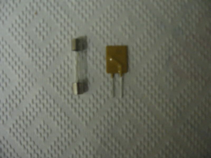

FUSES
Fuses come stock in most AEG's. They heat up and break the circuit when there is an over load of current. I typically don't run any fuses in my AEG's since i can rewire one on 15 minutes. but if you are concerned about your setup, here are some fuses.
glass or plastic automotive fuses
these are found in most stock AEG's. when they trip, you just pop in a replacement.
polyfuses(resettable)
These fuses gradually expand when heated to the point where they no longer conduct electricity. Once the current is removed, they contract and cool to the point where current can flow again. Once they trip however, they are tripped again very easily unless given sufficient amount of time to cool.
Glass fuse and a Polyfuse

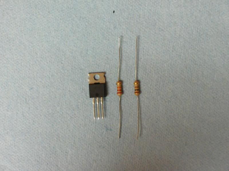

Here is what you need to make the Mosfet unit itself...
100ohm resistor
20-30k ohm resistor
suitable mosfet ( I always use IRL1404z)

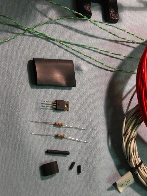

You may also want to find plenty of heatshrink tube in various sizes and the wire that you are going to use for the motor and for the gate wires.

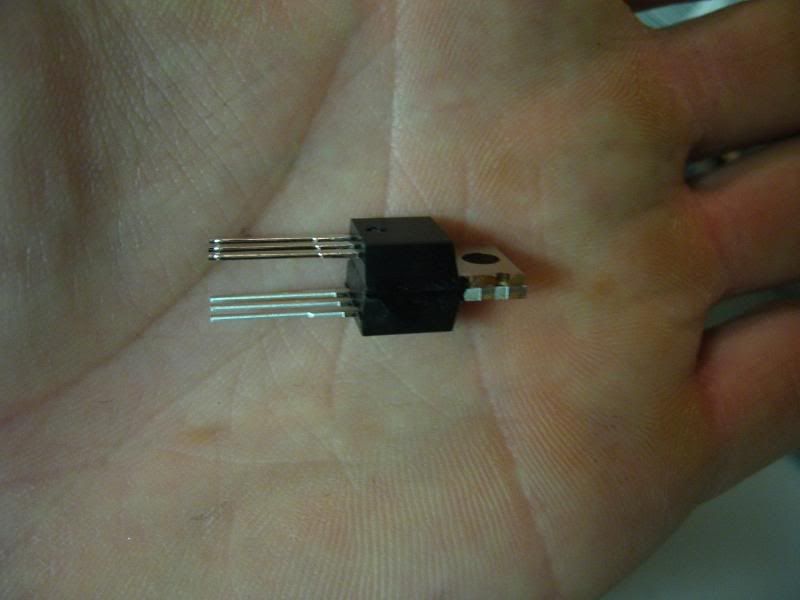

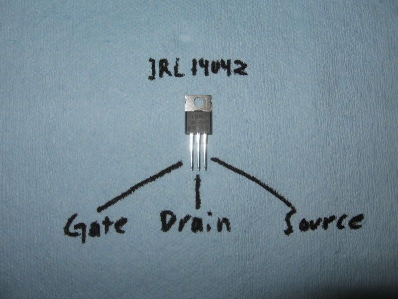

The Mosfet has three pins. Gate , Drain , and source.(see first picture)

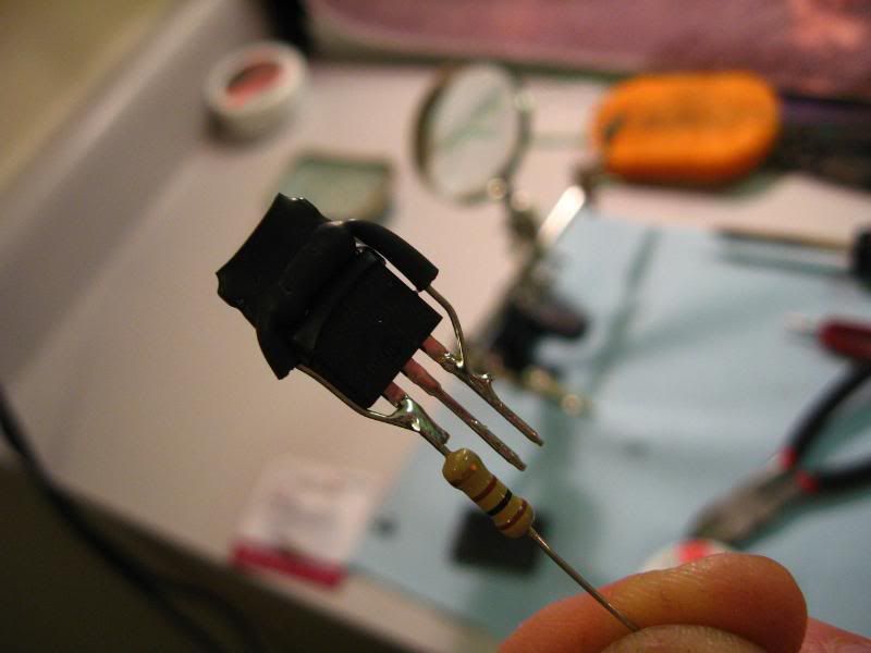

You need to put the 100 ohm resistor on the gate pin, and the 20-30k ohm resistor(pull down resistor) between the gate and source pins.

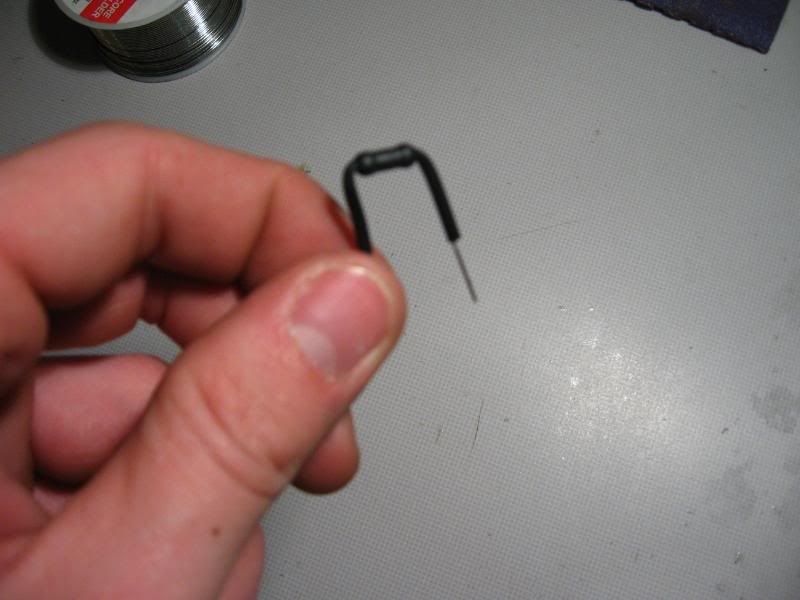

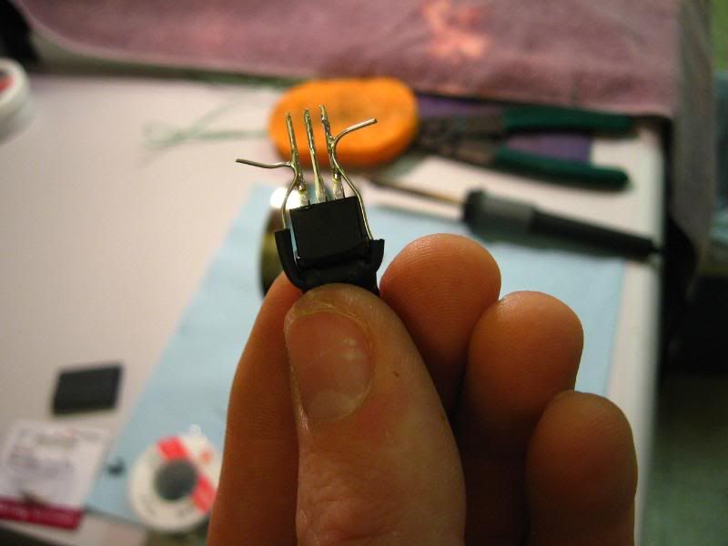

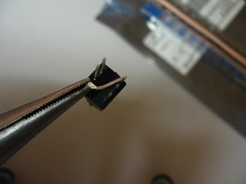

I like to cover the mosfets heatsink with heatshink tubing. I do this because the heatsink has the same electrical value as the drain pin, and i don't want anything to short out by touching it.
I also cover the pulldown resistor.
First i attach the pull down resistor...
and then the gate resistor ...

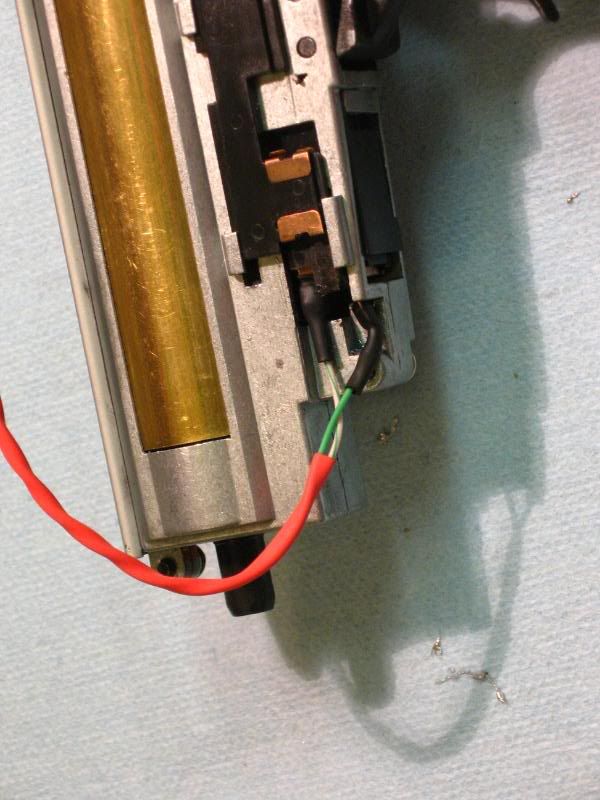

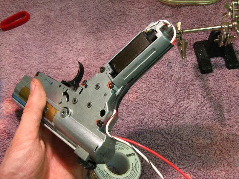

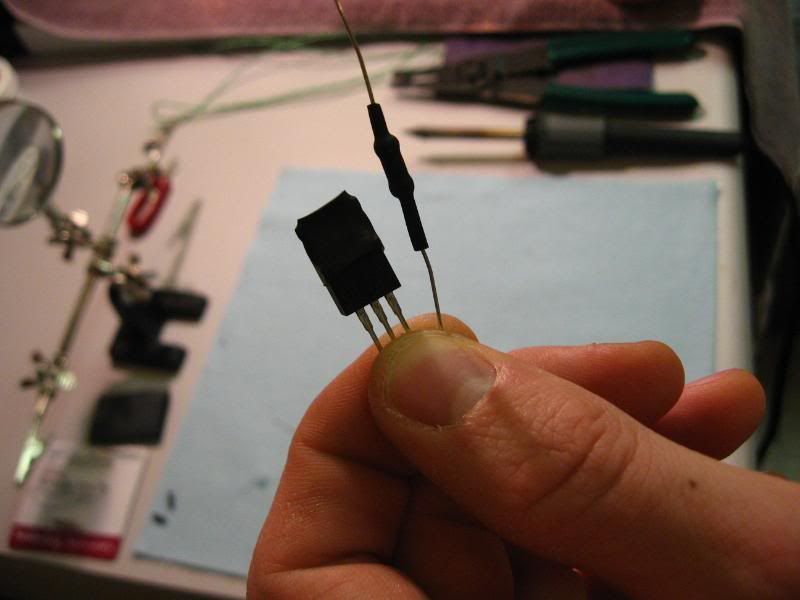

After that you are good to get started. rewiring. First you must desolder the trigger contacts and attach the gate wires. I typically use the small wires found inside of ethernet cable.
Desolder each trigger contact and attach a gate wire to each of the trigger contact tabs. it should look like this.
then you can add new wires that go straight from the battery to the motor.
No all you need to do is find a spot to put the mosfet. When you find it, clip the negative wire in half and take the side that runs to the motor. attach this side to the center pin of the mosfet(drain pin)
then attach the other end of the negative wire, the one that goes to the battery, to the outer "source" pin.
Then finally attach one gate wire to the gate resistor on the mosfet, and the other gate wire needs to be spliced somewhere into the positive wire.

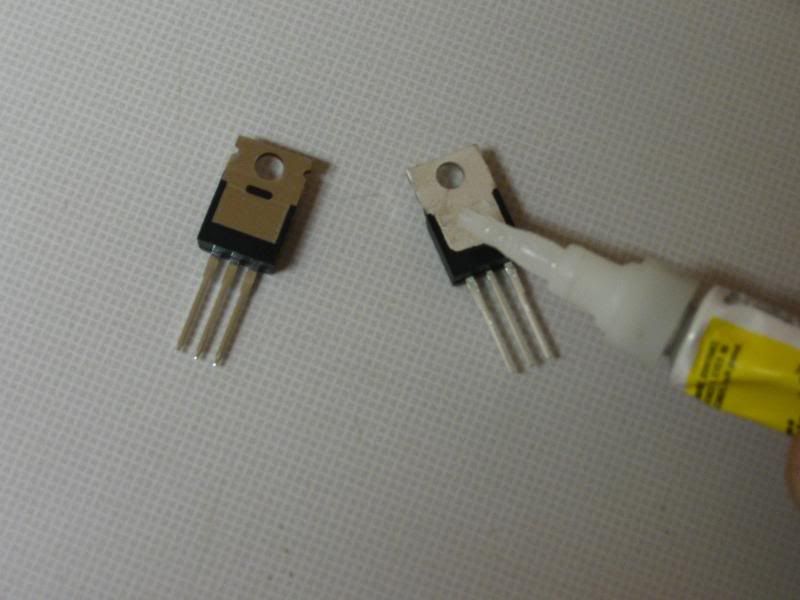

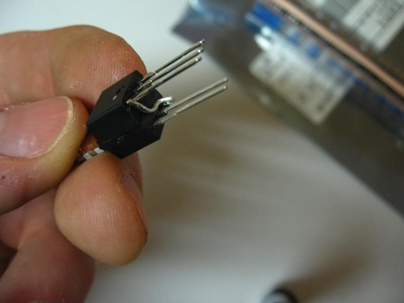

Here is a n-channel and P-channel mosfet. I start by glueing them together back to back.
here it is...

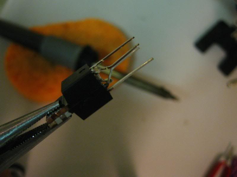

Then i bend the P-channel's gate pin to meet up with the N-channels gate pin.
Then i bend both drain pins(center pin) together and solder them as well...

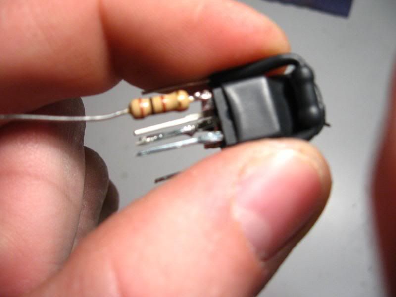

then I add the pull down resistor between the n-channel's gate and source pin as usual.
and finally add the gate resistor(100ohm) to the N-channel mosfet's gate pin.
Now You simply wire this in the same as you would a standard mosfet. The only difference is, you need to take the p-channel mosfet's source pin, and splice it into the positive wire. (see diagram below)

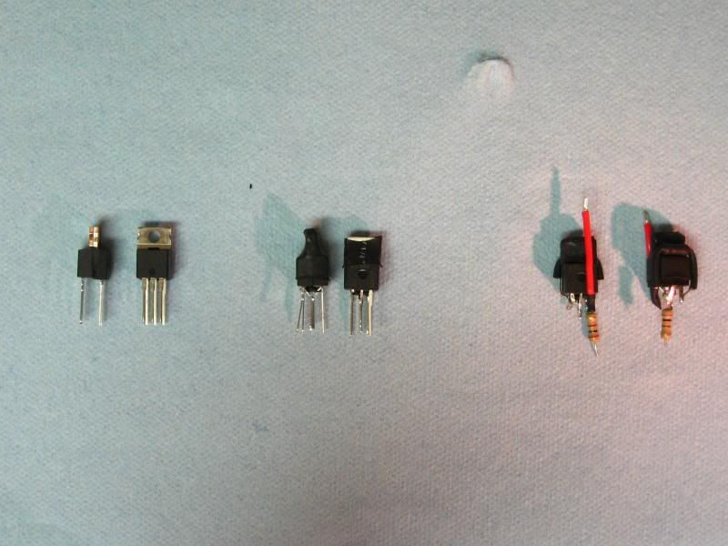

Here are some active braking mosfets in various stages of development...

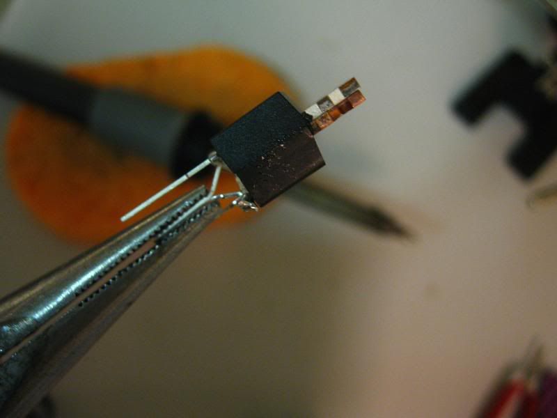

I've been looking around online regarding the AB Mosfet and I found this:
http://www.airsoftforum.com/board/lofiversion/index.php/t174497.html
Which is slightly different than the instructions here where it cuts the Drain pins and uses the top tab to connect to the negative side of the motor.
Now, my question is the following (based on that link's pictures):
1) Are they using the metal tab as the Drain? If so, then this would only work if you can connect both tabs right?
2) They used the purple wire to connect to the Gate pin ~ did they connect that purple wire to the other trigger (black wire)?
Again, sorry for bring back an old topic.
1,045 Posts
A/ Correct, if you look at pic 2 you will notice a line of solder where he has obvoiusly cut one heat sink off and used this then as the mating surface to solder the two together.

Anyhoo, take a look see at this one and see what you think, this is the one I always use
http://www.cerberusairsoft.co.uk/Mosfet/
251 Posts
Thanks Vindi.
The Cerberuairsoft one is clearer for sure.
However, that last note where he said to add a trigger wire to the positive wire... is it the same idea as what's shown in my linked URL, where the guy soldered the black wire to the yellow wire?
1,045 Posts
Here you go, skinned mine so you can see better.
The two thinner wires covered in heat shrink on the far left of picture, come from the trigger contacts, Wires coming in from right are battery feed, thick wires coming in from left are to the motor, Black and Black/Red = Negative, Red = Positive.
So you have the resistor in line with the thin wire directly to the trigger and the circuit is made by the return to the perminantly live positive, activating the FET switch..... hopefully that all makes sense ;)
251 Posts
Yes, I understand most of the wiring except for the 2nd trigger wire
Based on your photo, is that a split of the red wire at the far left bottom corner? If so, is that the thinner red (That is a thinner wire) that's heatshrinked to the black trigger wire, the 2nd trigger wire? And the thicker red (positive) wire at the bottom of the photo connects to the motor?
If that's the wrong assumption, then where is the 2nd trigger wire connected to the positive motor wire?
Sorry for being so inquisitive Vindi, just want to make sure understand fully what I'm going to wire
I hope my questions will also be useful for ppl who are asking the same question around the world
1,045 Posts
That is correct, its joined in there as this FET is out of my EBR/EMR, my other ones all connect directly to the source pin, where the positive battery to motor feed is just stripped off and soldered on or directly off of the motor where the positive is soldered to it, either is good ;)
1,045 Posts
chiba said:
Ahhh ok..
But now you've confused me with the second part... ??? You mean for all your other ones, the 2nd trigger wire is connected directly at the motor?
On 1 yes, and on a 2 others its connected to the same point as the positive lead is connected to the actual FET pin.
It really all depends on which weapon you are fitting it to and where the motor is situated in relation to the battery and the FET.
I.E. its my M14/21 that has the motor connection as the trigger wire doesn't need to go past it as there is a positive lead already running to the FET and then straight on past on the the battery.
On my SR25 on the other hand its off the FET pin as the motor is in the hand grip and its nye on impossible to run a third wire from the motor and through the gearbox, same with my G36Cniper.
The one Ive posted a picture of, as your now aware, is from my EMR and that is different again because the motor is in the very rear of the weapon but the FET and battery sit at the other end in the foregrip, luckily there is enough space to fit 4 wires down the side of the gear case, past the mag well and into the trigger mech, then the two 16 guage wires carry on to the motor, only just clearing the semi latch arm.
As long as its connected some where along the positive lead you'll be fine, as long as you are using the positive lead as your perminant live, which if you follow most guides you should be ;)
