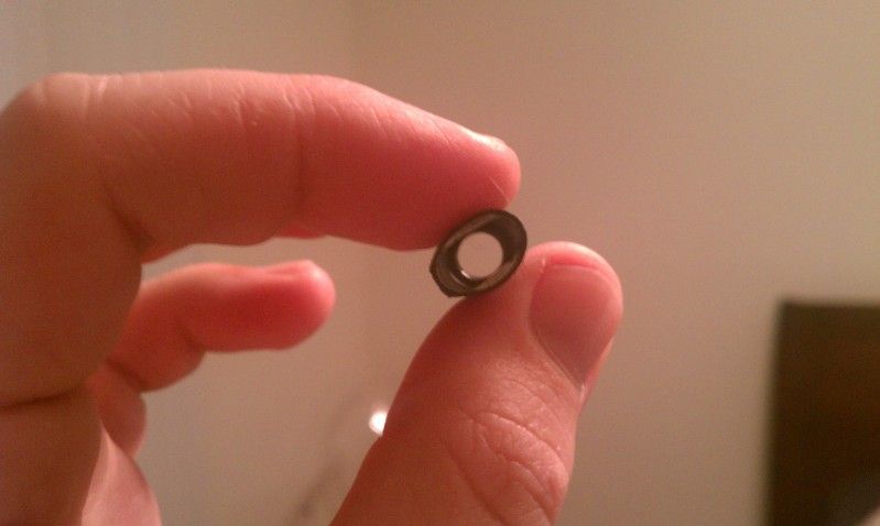

Discussion Starter · #6 ·
Removing the rubber bumps on the inside of the bucking... Worked!
I also used the mod that allowed the 100% seal with dental floss on the bucking.
I was easily hitting a target 150ft with out any lobbing. I can
