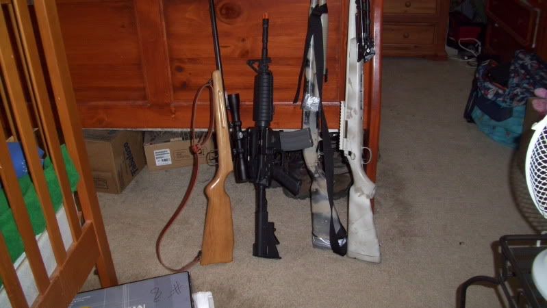

Here are my guns:
My SG R700
My Tasco is broken :(
My DE M58a Shotgun
My CA M15
And My .22
I use a Barska on my .22. It is actually really crappy in comparison to my Tasco. (Before it broke)
Group photos
Shooting Remington High grade ammo for my .22. Effective at about 400 yards. By far the best .22 ammo out there.
I have a question about the M15 though. My flash hider stripped, How do I get it off?
Do you mean the hex screw stripped, or your whole flash hider stripped? Your best bet is a screw extractor.
http://www.google.com/search?hl=en&source=hp&biw=1259&bih=878&q=screw+extractor&aq=7&aqi=g10&aql=f&oq=screw
Though judging by the precious little face I saw in a few photos, not to mention the proximity of the crib. You might try (though this procedure will void your warranty lol) a file and shave off 2 notches in your screw. Thus making your stripped hex screw, an impromptu flat head screw.

My hex screw is stripped on my M15 and I have tried a extractor. The problem is is that the screw is not the same quality is the rest of the screws and it is rusted. How would you advise me getting the rust off without messing up the flashhider completely.

To remove the rusted screw, try heating the flash hider with a torch. Remove the inner barrel/hop up assembly so you don't cause that to heat up and ruin it. A lot of times heat will help you break the rust and get it out. If that can't be done, you can use a drill bit and drill out the screw, which should cause minimal if any damage to the flash hider, just make sure you don't drill too far into it and go into outer barrel. The last option you have, you're gonna need a file or dremmel with a cutting bit, cut into the screw long ways, across the base of the flash hider, which will cause the screw to break and you can remove it that way.

For the rifle problem....... try and get your hands on some torque bits. They are the ones that look like little stars. Find one that is a little bit larger than the allen key that you have on the muzzle break. Take a hammer and GENTLY tap it in. You should be able to get enough torque on it to pop her out.
Then if that doesn't work, just get a drill bit and drill it out.

I was very fortunate and found A torque bit just the right size for my hex screw. I heated it up and twisted, twisted and twisted some more. Nothing. Should I spray it with lube. I was concerned only because my lube I use if flammable. And shed floor doesn't take to good to fire, being it is made of crappy wood
602 Posts
Usually it isn't the lubricant itself that is flammable, it's the propellant they use to make it aerosol that's flammable. I'm not saying you should try it and cannot be responsible if you do and it does catch fire, but typically it's safe. If nothing else, spray it down with lube, let it sit for 30 minutes or so, dry it off the best you can and then try heating it.
3,788 Posts
What Dutton said
Get a pot of water boiling, and stick the tip of your barrel in. Just make sure the rifle is apart ;)
And you are sure you are turning the screw the correct way? I only ask because I know I have done it the wrong way, and with some airsoft guns the threads are reverse.
362 Posts
Discussion Starter · #20 ·
I got it! The hex screw was forced in the flashhider because the flashhider is standard and the screw is metric. So the weren't compatible. I stuck it under boiling water. Used a torque bit and had my brother hold the gun while I twisted and it just POPPED! I really appreciate the help guys :) thanks
