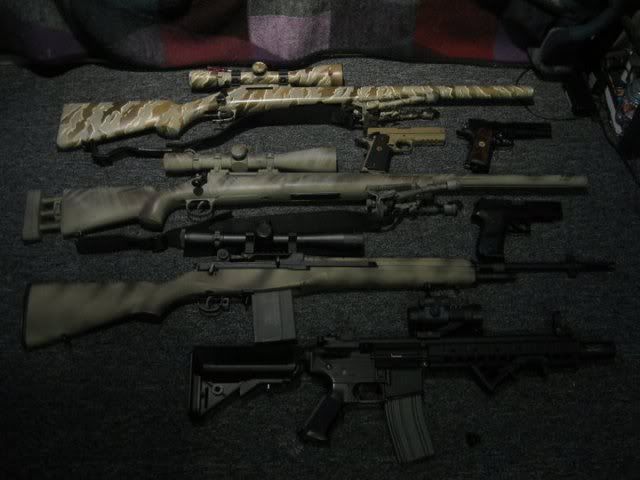

Hey guys, long time reader, brand new member here. Im really digging all the info and seriousness about airsoft sniping there is around here. After trying to get into it seriously for years with a bunch of "why would you do that" from other players i'm glad to see im not the only one who's "crazy" haha, anyway here's what i got going on right now:
almost the whole family

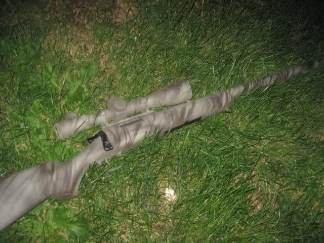

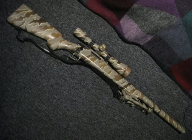

JG BAR-10 Gspec
The Infamous Gspec:
Laylax Zero trigger
Laylax Teflon Cylinder
Polar Star Piston with 90* End
Polar Star cylinder head
Laylax bearing spring guide
Laylax 170 spring
Marui Precision Hop Chamber and bucking
Hop Up mech shimmed
PDI 6.01 Bull Barrel
PDI Light Outer Barrel
PDI Barrel Cap
Polar Star Barrel Spacers (6)
Replica Leupold Mk 4 Scope with illumination
Rockmount Bipod
Winchester Sling

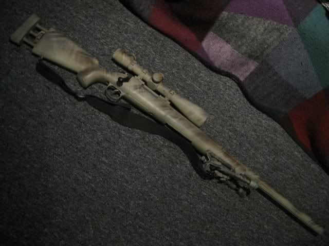

630 with .20's, effective out past 300 feet with Bioval .40's
Echo 1 m28
Upgraded Parts:
PDI first sear
PDI Second Sear
Daiki Spring Guide Stopper
Marui Bucking
Laylax Spring guide with bearing
Shimmed hop up components
Replica Leupold Mk4 scope
Everything else is stock
~525 with .20's

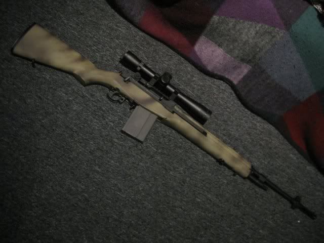

Tokyo Marui M14
Prometheus Ori. Ratio gears
Matrix 3000 Magnum motor
Guarder bushings
Systema shims
Prometheus Hard Piston
Guarder Aluminum piston head
Systema m140 spring
Bravo AMU2 Mosfet w/ Braking
Prometheus 6.03 tightbore
Systema Bucking
Concave Spacer
11.1 2600mah 25c Lipo
Replica Leupold Mk3 scope
King Arms m14 scope mount
King Arms M3 scope
Mag 190rd Midcaps
500 with 20's

Hope you guys like 'em, more to come later this week when i finish my newest build!
Thanks for looking!

Discussion Starter · #4 ·
thanks for the kind words guys, i appreciate it!
Yeah all the internal works is done in house by myself, ive been arsoft teching for ~7 years now and i'm pretty much at the top of my game now if i fo say so myself ;) haha!
and thanks! a close friend of mine did the paint job for me, it came out fantastic! a year of playing and the only real wear is in the major contact points, held up very well so far!
