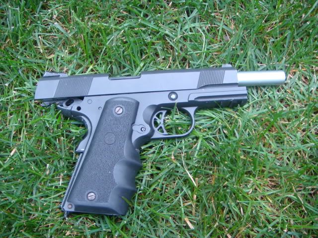

Here is the pistol itself if anyone is interested.

Pictures!
The gun itself for your reference (shown without some parts) --nothing important or related
