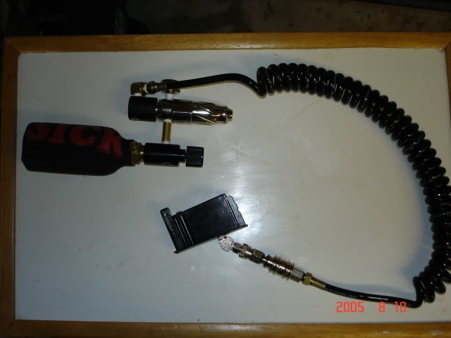

So what you want is an asa or well one of these ( http://www.zephyrpaintball.com/category/paintball_pro_shops.custom_products.custom_products_on_off_paintball_asa_s/ ). From there you run it into your reg, if I can I will get a pic of my rig.
Now the only thing is that there will be residual air from the mag to the reg, so if you have a quick disconnect set up there will be air loss.
To depressurize the bottle you can use the hose and us it as a key board cleaner.

The fitting at the bottom of the picture attached to the hose screws to the top of your bottle and on that is a knob that will depress the pin on the ASA fitting so you can turn it "on" or "off". The other side has a QD fitting, and if you look around you can find other remote lines with a check valve on it for a little more.

So this is how you want your set up> tank> asa on the tank>reg>coiled hose> gun mag.
