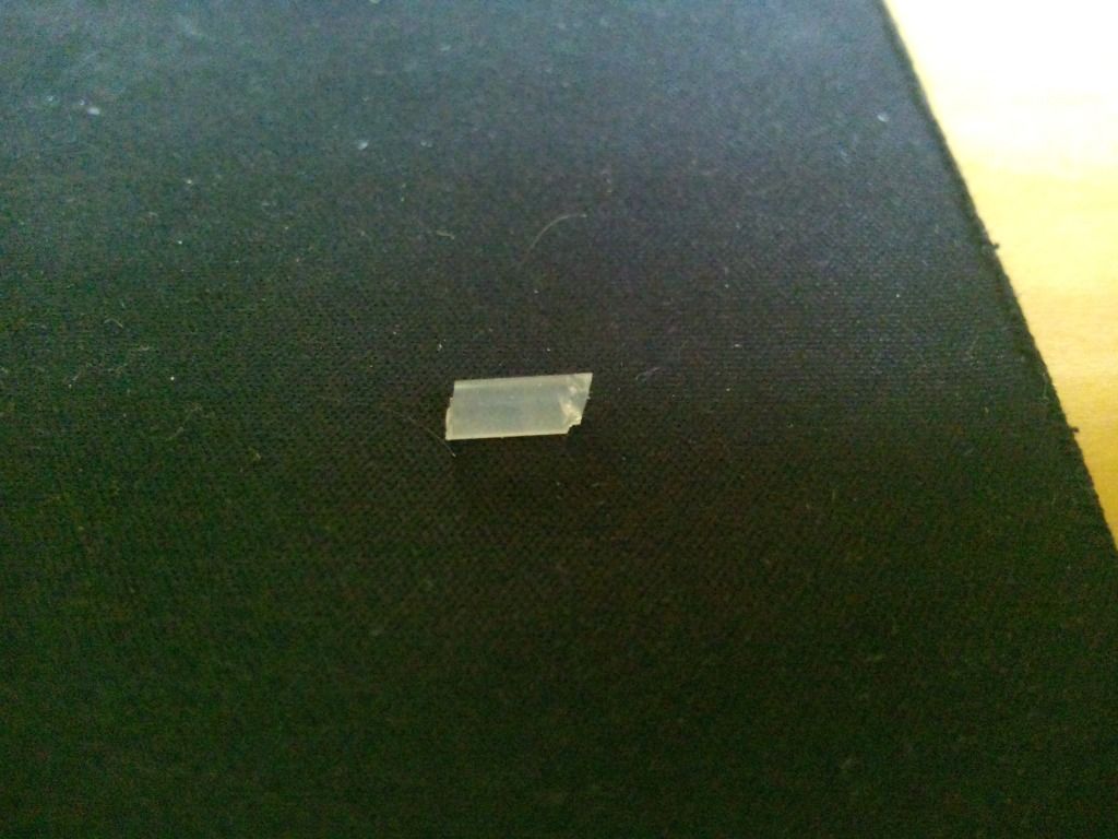

Not sure if I brought this up before but it's a problem I have been having off and on.
I mentioned my gun was hooking far right, and I thought I solved the issue but its back. here is a picture of the nub PDI gave me with my hop-up.
Is that the right shape? The reason I ask is because It doesn't want to seat properly when I pop it in the hop-up. Thanks guys!
The nub they give you is crap. Use a metal bar, a thick wire works pretty well too.
Going to change my nub as well then. Do you know what size bar it needs?
For a nub in the PDI chamber, people have reported success by using a pen ink tube. Like, the plastic tube inside of pens (any old pen like a bic pen will do) that holds the ink. Some complain that the ink tube is too hard, but I think that stiffness means consistency, while flexibility is opposite. I even managed to use an old Lego flagpole piece and cut it to fit.
What you could also do is use an SCS or PCS or H nub (which would be pointless if your bucking has a concave nub or anything like that inside like a PDI W-nub bucking, but useful if you have a flat nub or no nub). Simply use some non-drying modeling clay to "stick" the nub to the hop up arms. You can easily find some of the clay at a Walmart or Target in the arts & crafts section. When you stick the nub on though, you'll have try and make it as centered on the arms as much as possible.
Like I mentioned in another post, I found a nail that was roughly the same diameter of the nub/space needed. Cut it, sanded it, and I have not had any problems since. Like what lulukchoo was saying, from my experiences stiffness means consistency.. but I'm no expert.
