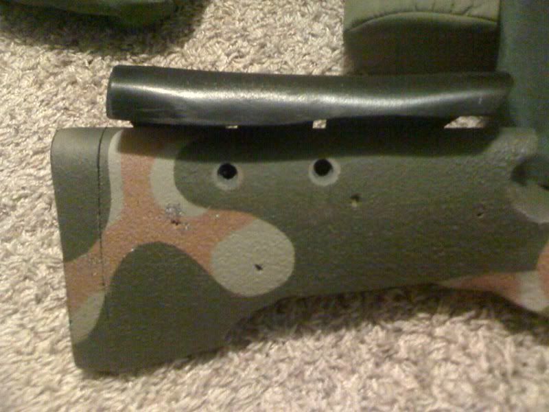

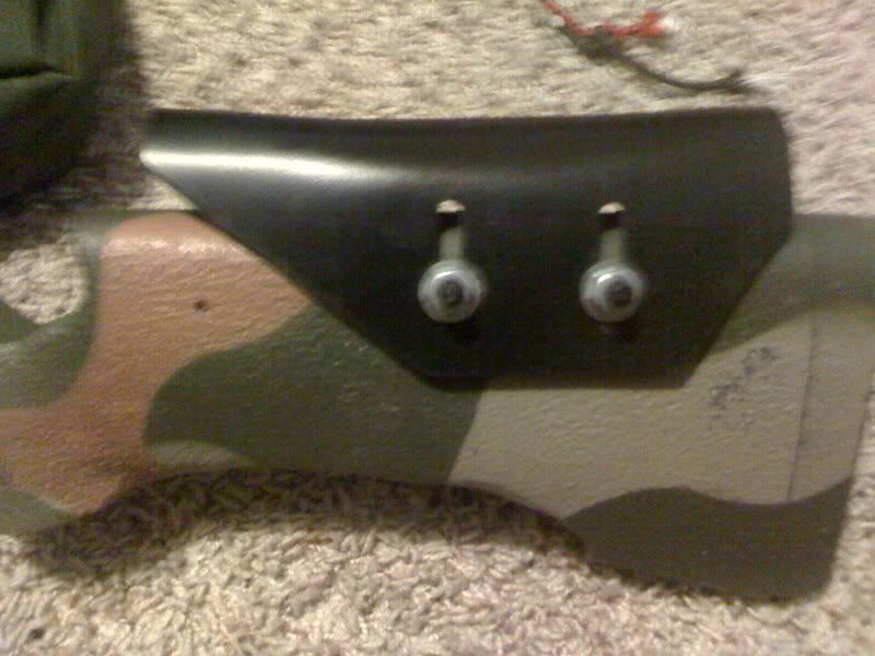

I finished mounting the cheek adjuster this evening.
The silencer
Other side of the cheek adjuster

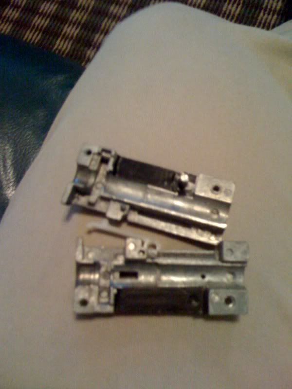

Today I decided to work on the parts I had already, so first I worked on the hop up. I took black electrical tape and shimmed the sides of the hop up. You may notice that I didn't cut out a few spaces, but don't worry it is all for a reason.

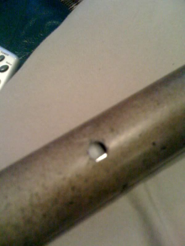

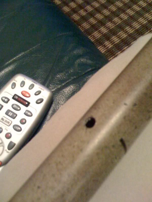

Then I drilled a small hole on the outer barrel
As you can see, the hop up arm is now visible from the outside of the rifle.

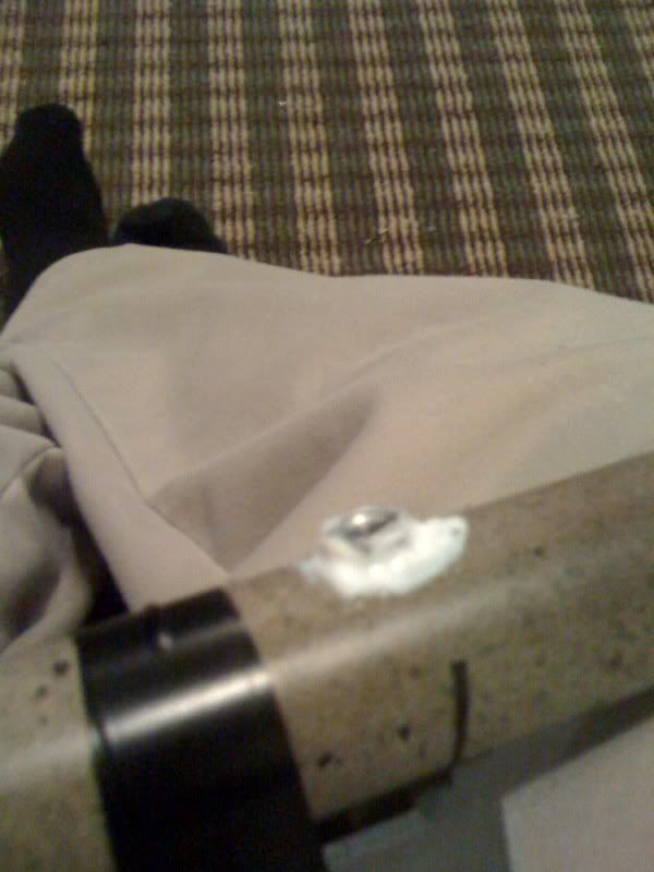

Then I found an appropriate bolt and nut, in my case a sling mount screw
Lastly, I glued the nut on the top of the barrel. I am slowling adding glue to make the nut flush with the barrel, but I'll add more pictures when all the glue is dry.
By now, you know that I'm making my hop up adjustable by just turning this small knob.
Today I also filled the stock with clay.
