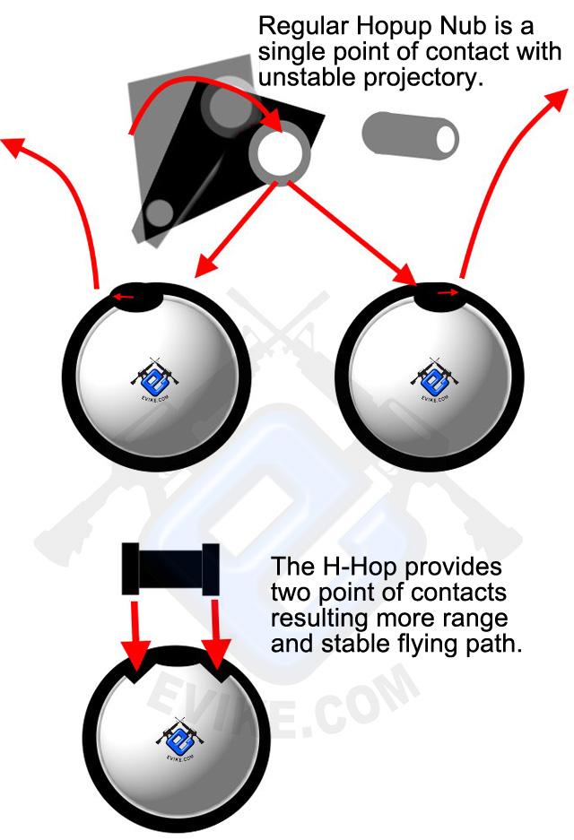

This image is from evike,
so how is one contact better than two???

Alright, unless you can give us something to back up your arguement (other than a picture from a company that tells people to clean barrels with silicone oil), I give up trying to explain this to you. We've already told you exactly why one contact is better than two. Did you even read anything in Vindi's post other than that last line? We are always trying to improve upon things, you should know that by now. We are trying to tell you though that having multiple contact points is a liability, not an asset.

In the case that that your picture shows, then yes, 2 points would help, but they are still a liability, as even a H nub can cause uneven flight and can be a real ball ache to set up properly.

Two contact points would theoretically do the same. The rubber is pushed down on the left and right. The area between the point will stretch, in the contour of the bb. This would result in a dynamicaly adjusting "concave" contact area. The downside is that the amount of stretch isnt consistent.
