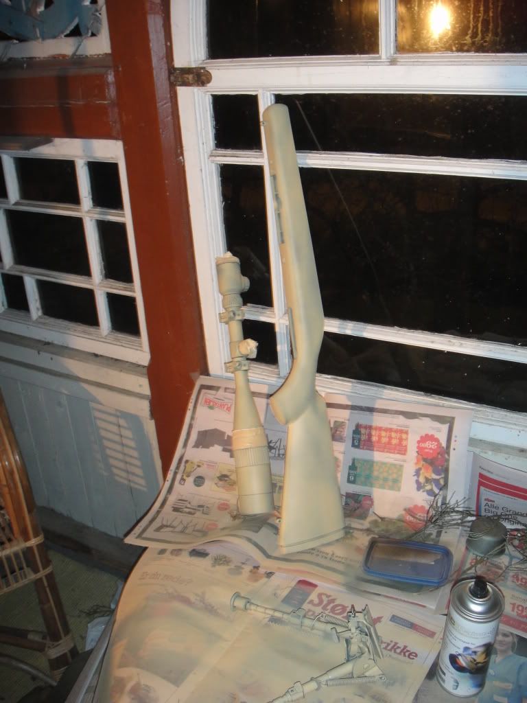

Step 3
Start off spraying the whole rifle with your lightest color. Cover everything, and make sure not to hold the spray can too close to the rifle as this will make the paint run down your rifle. Smooth, sweeping motions is the key. Spray thin layers several times until you can't see what is beneath. Then let it dry for about 15 minutes (or whatever the info on the can says). Now it should look something like this:

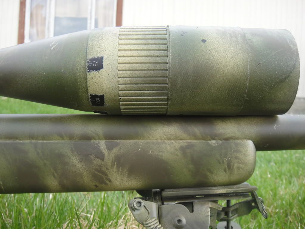

Step 4
After your base color is dry, give it a few stripes or spots of a slightly lighter color. Like this:
This will be the color of the foliage, and by giving it multiple tones you create some depth and dimension to your camouflage. Do light, but firm strokes and let it dry before you spray some more over the places you want to be darker. Random spraying worked for me.

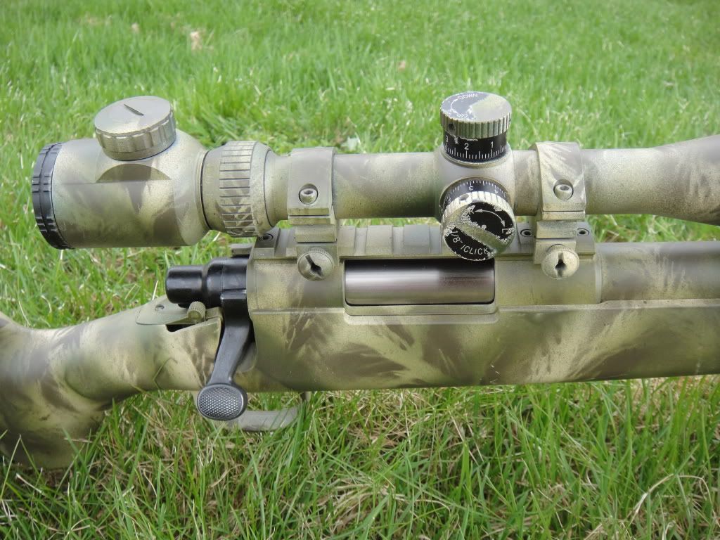

Step 5
Assemble your rifle without the bolt, as you usually don't want it to be painted.
We are now going to make the background, which I the darkest color you will use. Get your foliage and Dark color(s) and you are set. Start by laying the foliage flat on your rifle. The closer the foliage is to the surface of your rifle, the sharper the outline. A handy tip is to do a test run on some other surface, and then move on to the rifle when you think your results look good. Experiment with different types of branches, twigs, grass etc. If you mess up, just let it dry and repeat step 3 and 4 on the area.
Another method is to hold the foliage firmly on certain spots and spray short bursts over it. This method is useful when painting areas like the top of the scope and on the barrel.
Don't forget to camouflage inside the flash hider or end of the silencer. This is what the enemy will look at if you are pointing at them, and you don't want them to see a tiny black circle. Besides the scope signature and reflection, this is the thing that is most likely to give yourself away when pointing at someone.
Step 6
Let the paint dry and if necessary put one some more paint if you feel that something should be better. remove all the tape.
Insert the bolt and you are ready to go. Enjoy your new rifle!
