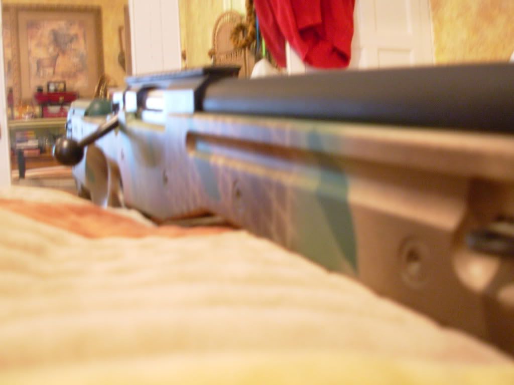

**UPDATE**
Here is a picture of the gun with the scope attached. I had to reorder the rings because I accidentally ordered the wrong size the first time, so here it is fully complete!

**UPDATE**
