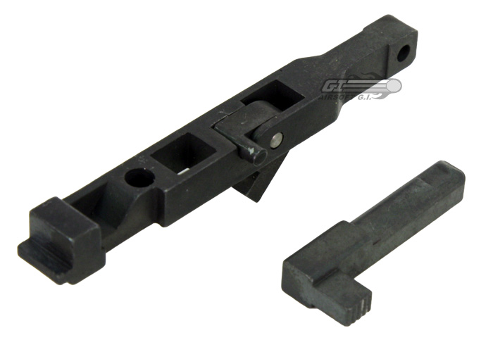

Only recently did I discover why; study the picture in the link below. Notice the silver colored pin that goes through the assembly. It allows the piston sear to pivot in the trigger sear.
http://www.airsoftgi.com/images/airsoft_ASGI_VSR10-SearSet.jpg
When I disassembled my trigger group, I found that the pin had worked it's way out of one side of the piston sear, and was allowing the piston sear to bind off to one side, causing the slam fire issue.
remove your trigger and take it apart to see if indeed you are not suffering the same issue. Although not slam firing with the new piston, yours may be binding and causing your piston to hang against the cylinder wall or slot... worth a shot to check it out.
If you have any trouble getting the trigger back together, we can help.
