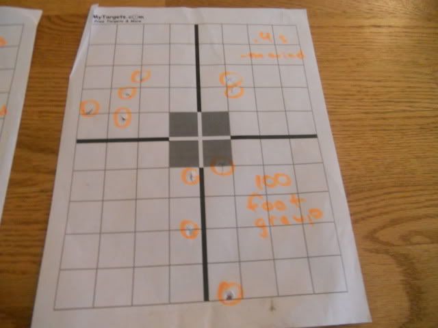

Groupings:Standing Position, no bi pod, minimal winds, .4 madbull bbs, 100 foot distance

3. O-ring Modded Hop up arm:
Did this mod on the fly, right before a game. Saw someone talk about this mod online and decided to give it a try. The object of this mod was to shave down the original hop up arm, just enough so that a small o-ring could go over top and around the hop up arm and sit on the fangs. This would in theory, help provide even pressure on the hop up arm.
The results were actually quite impressive, a big step from the PCS mod. The shots were much more consistent, and while less pressure was now applied to the bucking, I still had enough hop to push the .4s out to a pretty good distance. I was pushing around 200 feet accurately with an SP130 spring, which clocked out at about 375 fps with .2 gram bbs. Not to shabby if I say so myself...
However, there were a few problems. Occassionly the o-ring would slip off the fangs and sit on the side of the bucking, rendering itself useless. Shots became less consistent and since the fangs were shaved down, the pressure on the bucking would become susbstantially less.
In addition, when adjusting the hop up for different weight bbs, the o-ring would slide around and snag on the side of the chamber. This sometimes made the pressure on the bucking a little "off" and curving would occur.
Overall, this was a decent mod that when installed right, was actually pretty nifty. Got rid of the curving issues most VSR models have while at the same time keeping shots relatively consistent.
Grade: 91 Proved to be a worth while mod, and a rather significant improvement over the PCS mod. Consistency went up and the amount of hop on the bbs went down in comparison to the PCS version. However, compared to the stock hop up, the o-ring provided much more hop and could carry a .4 on about 50% setting. While consistency increased, I was not 100% happy with the mod. There were a few shots here and there that "escaped" the normal line of fire, and these imperfections proved costly on the field. Granted, towards the end of the reign of this mod, it was near winter, when the winds picked up substantially and proved to affect shooting quite a bit. If anyone needed a home made mod, this would be the one to try and would be relatively happy with it. A high B for the o-ring mod, although I am sure some will find it to be "A" worthy, as it truly is a useful mod.
