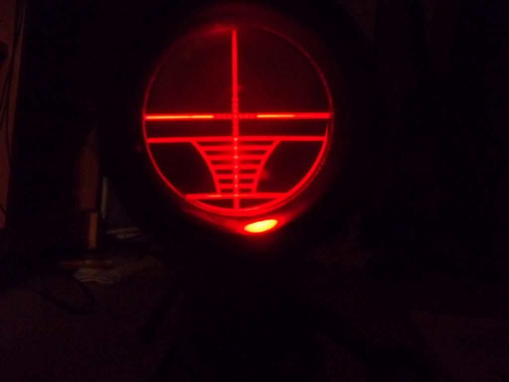

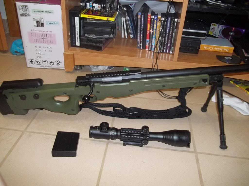

When I first saw the M4402D, I was eager to own one, seeing as it looked more realistic than other L96 models. The M4402D is a clone of TM's L96 AWS It came with a bi-pod and a 4-16x50 scope which has a range estimating graph reticle that can be illuminated to be red or green.
Scope reticle:
The rifle weighs about 10.8 lbs and has a length of about 4 feet. Most of the internals are metal with the exception of the BB loading ramp and the piston and spring guide. The piston and spring guide will need replacing, especially if you plan to upgrade the spring to gain a higher FPS (stock it shoots about 400 FPS).

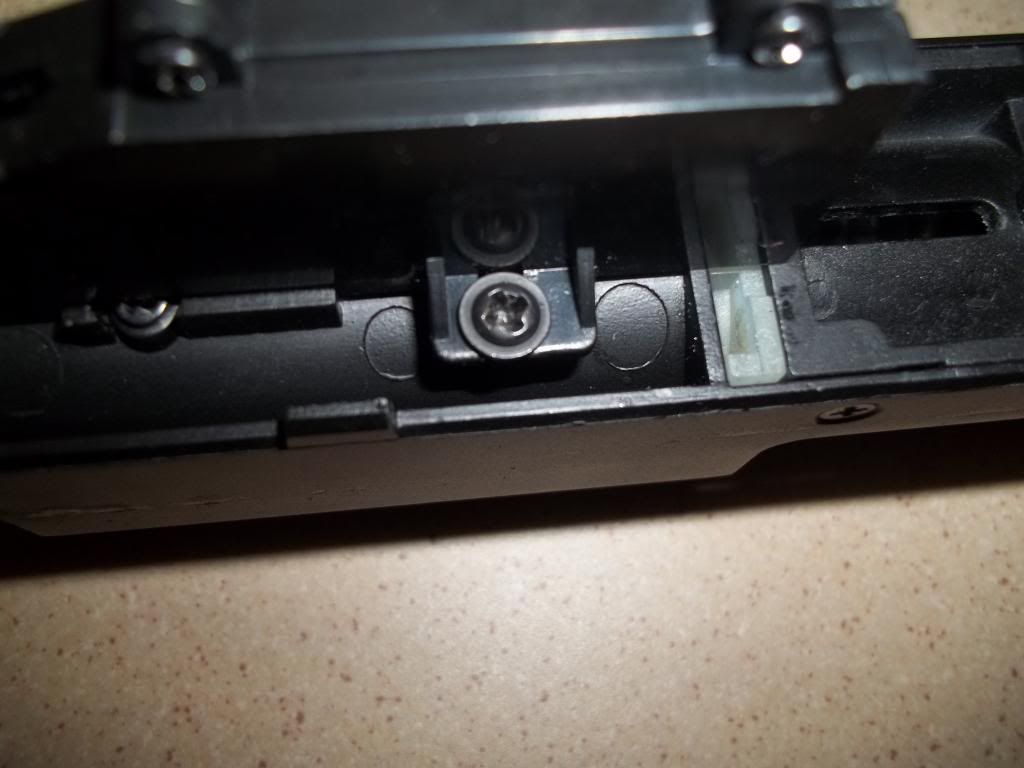

First, take off the scope and take out the magazine, make sure there are no BB's in the chamber.

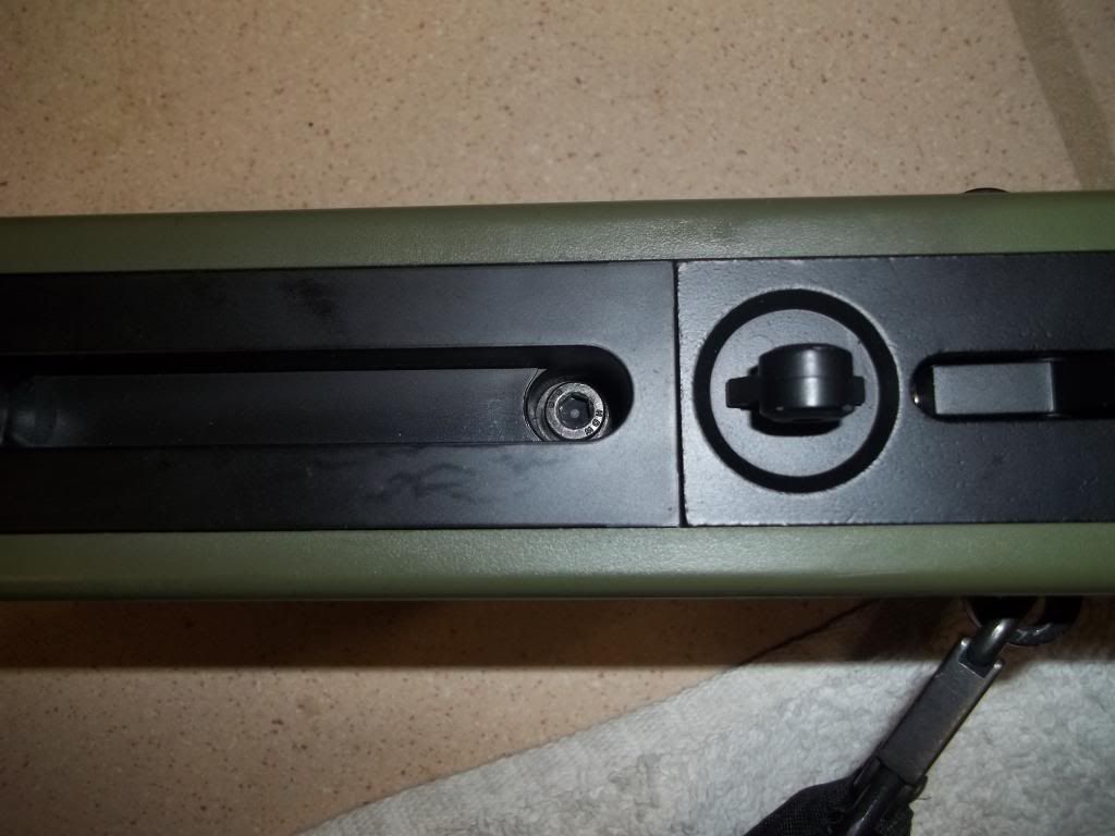

Then you will unscrew the two screws holding the receiver to the stock. The first is located in the mag-well:
the second is located in front of the hop-up dial:
The receiver will then lift out of the stock
Turn the receiver over and remove the BB feed ramp and The trigger box

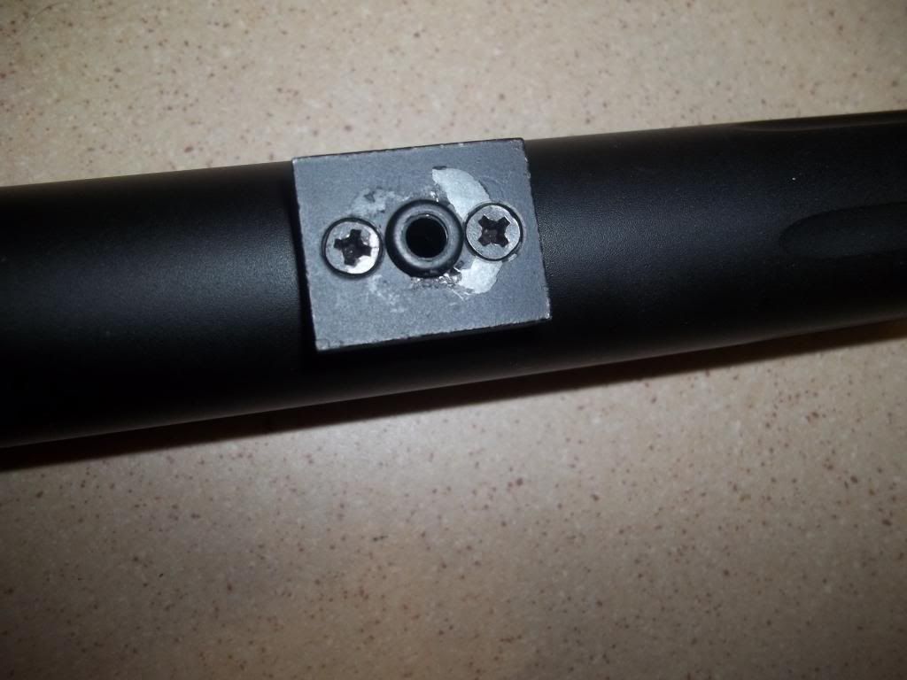

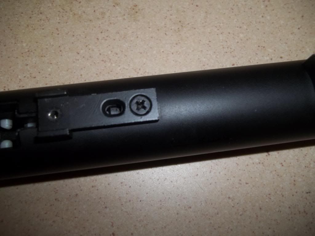

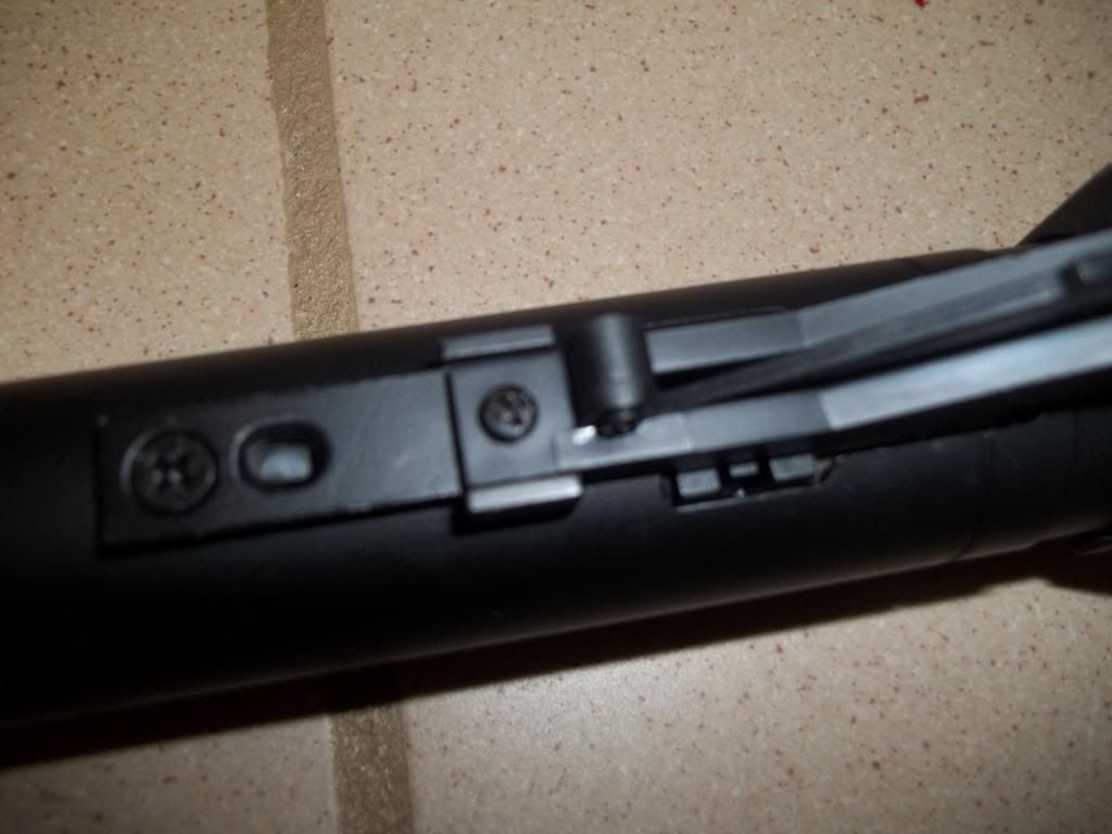

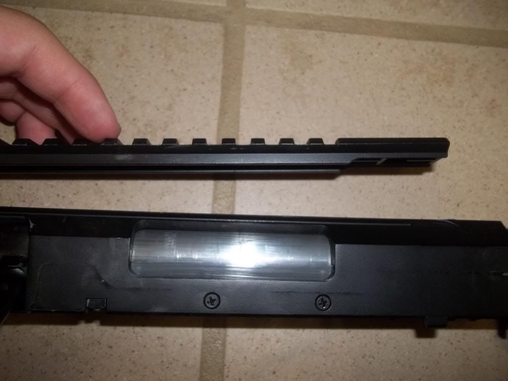

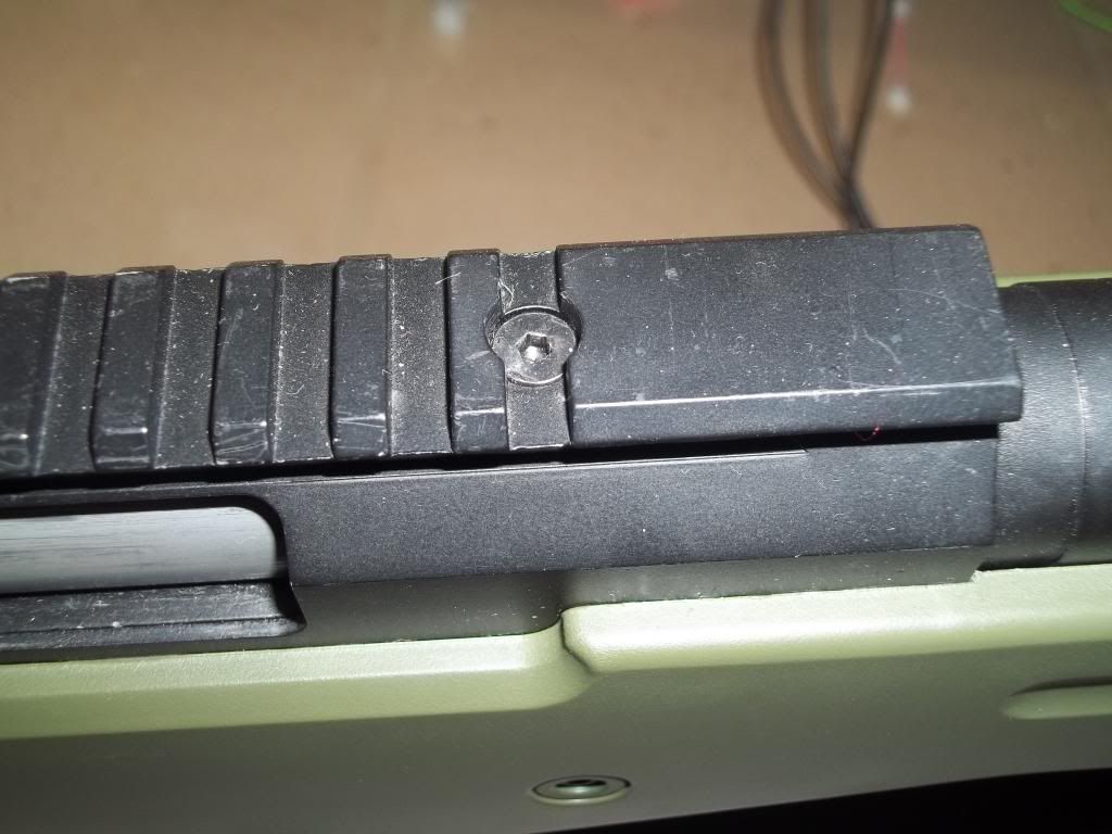

In order to get to the cylinder you must take off the BB Feeder. To get to it however, you must first separate tthe barrel from the bolt assembly. first unscrew the rail from the bolt housing
there are two screws on the rail
then take off the to rail and unscrew the screw underneath

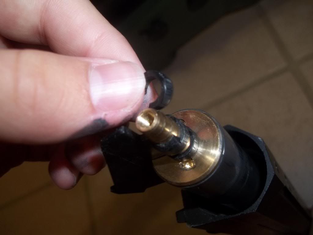

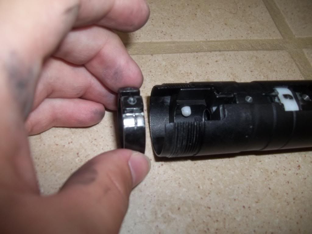

Unscrew the barrel to find the BB Feeder with a c-clasp. take off the c-clasp and pull the bolt out
use needle-nosed pliers to take off the cylinder head and pull out the piston

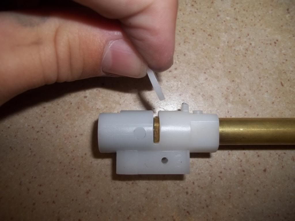

To get to the inner barrel, there are two protrusions on the outer barrel, unscrew them, and pull out the outer barrel
When pulling the inner barrel out, beware the springs that are in the hop-up unit
http://s1336.photobucket.com/user/Alpha-57/media/100_2851_zpsaa48c8fc.jpg.html?sort=3&o=6
Reactions: 4
18

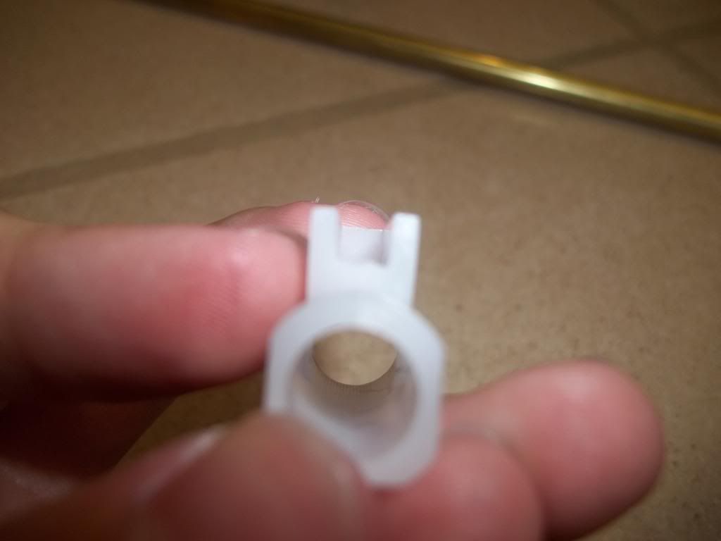

then unscrew the two screws in the front of the hop-up unit, pull it off, then push the pin from the hop-up arm to get to the nub, pull the plastic piece off the inner barrel to get to the hop-up rubber
