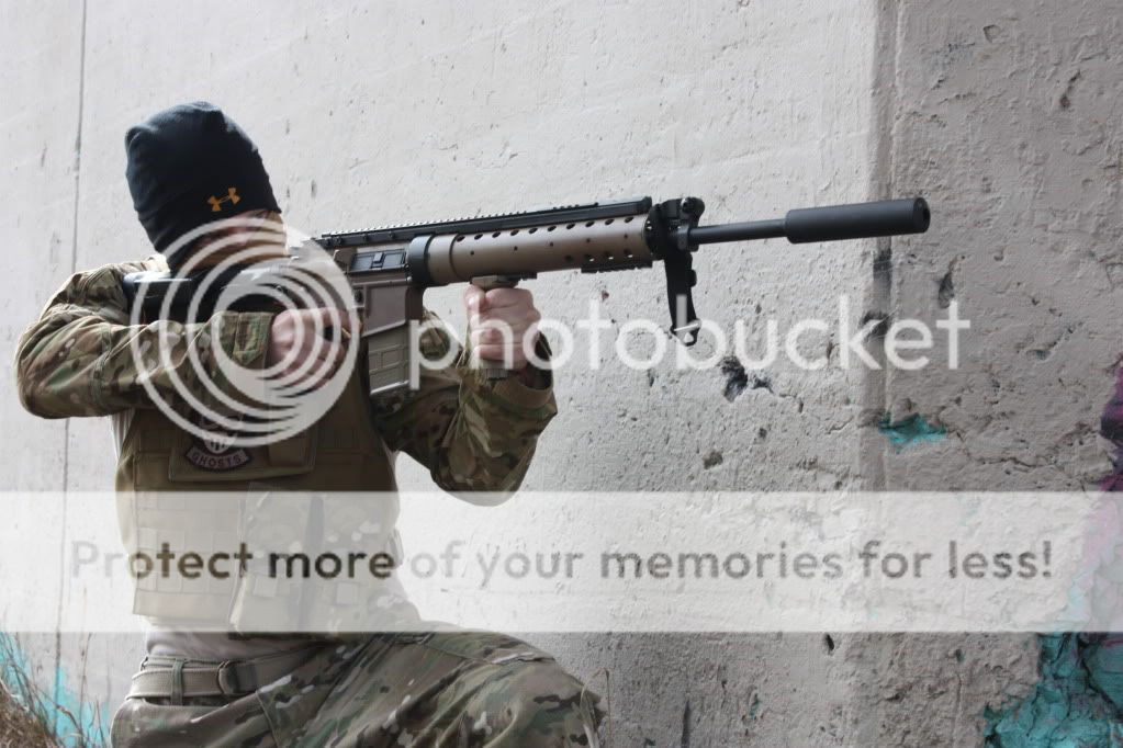

Here is my gun. SPR mod0 body with a 20 inch outer barrel+suppressor. Skeleton stock (hoping to upgrade to magpul prs stock soon). I have and upgraded gearbox with a variety of different items in it. They are good but not the best. When anything breaks I'll get the best :).
It was shooting 335 fps with .3's using an m130. It has a nice rate of fire too. I would like to take it to semi only and pu an m150 in for some true single shot action.
